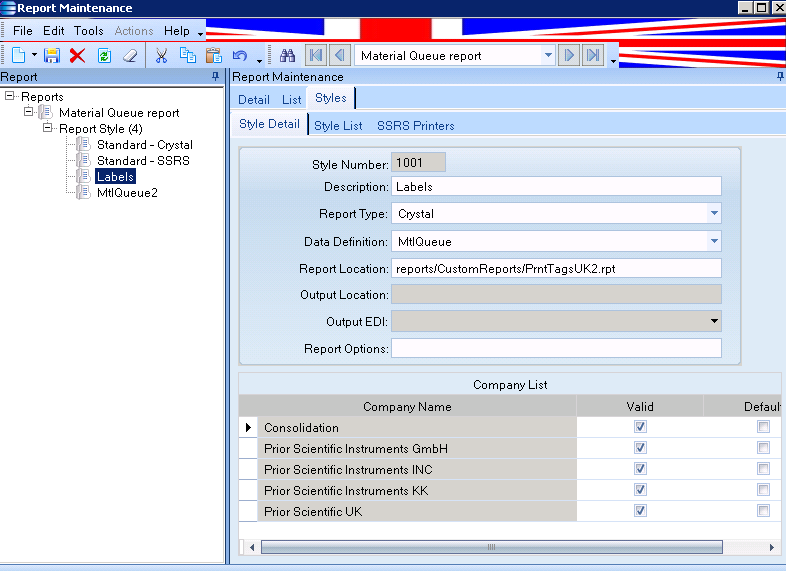

There is a standard report style named “mtlqueue”, in there are 3 report styles, Standard Crystal, Standard SSRS and Labels.
I needed to add a fourth style (which i named mtlqueue2)

  1. Made a copy of the original crystal report and called the copy “mtlqueue2”
  2. Found the data definition that drives the original report which was “mtlqueue”, i duplicated the definition (calling it mtlqueue2) and added the part table and applied the correct relationships.
  3. I went to the report style and added the fourth style named “mtlqueue2”, pointed it at the new crystal report and it all worked when ran.
However the problem is now the labels report doesn’t work…and i haven’t touched it!..and its a different crystal report entirely!..AND IT DOESN’T WORK IN ANY DATABASE INCLUDING LIVE!!!..how? what?
So, the Standard crystal works as normal, the new mtlqueue2 report works but labels doesnt on any database, even though i only did this work in TEST
When i run the labels report it simply shows blank data apart from where there is text fields hardcoded in.
