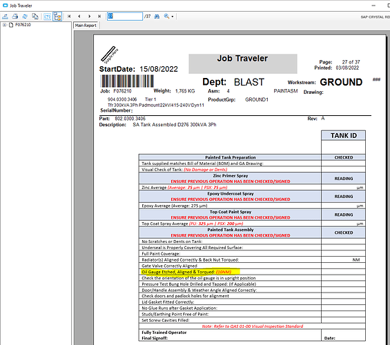

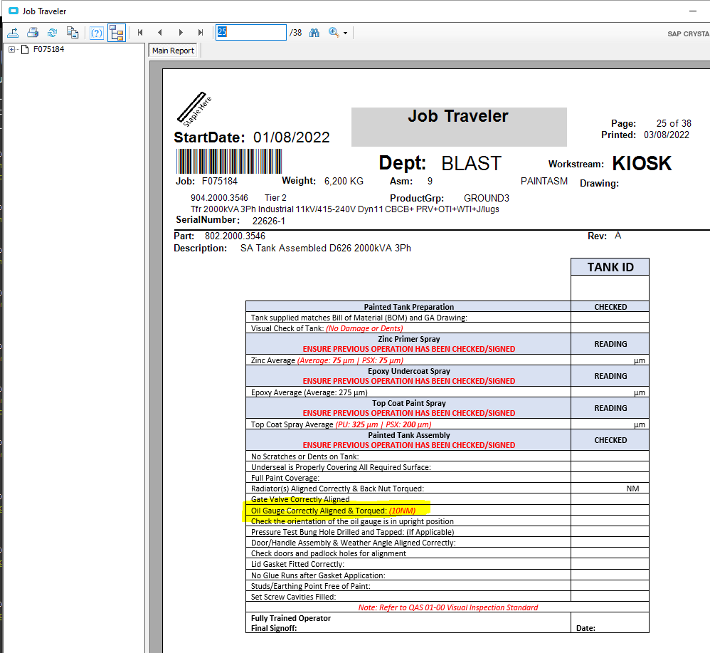

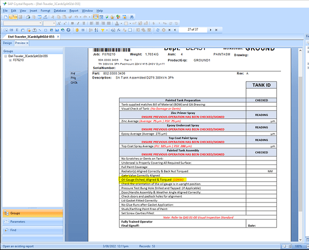

We modified Job Traveler Report as below (Print Preview screen) highlighted is the change we did.
Print preview seems perfect, but when we tried printing it on Epicor, the changes doesn’t take effect. It still uses the old report.
But when I try the Job that was used for the Print Preview, it shows the correct one.
