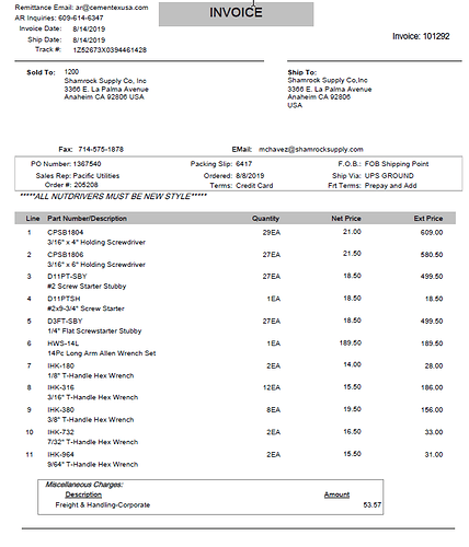

I have an odd situation just wondering if I am missing something. If I ship a partial on an order why is the entire order balance charge?
Anyone see this before or know what I need to do to only charge for the items that are shipped?

but are you certain the payment amount was $3411?
authorizing and payment are different.
have you confirmed the amount from the PP website?
Not sure how to realize all this…appears per the invoice that full amount was paid. Perhaps it’s the wrong information pulled into the SSRS report. Which field should it be?

good morning - you say the shipment actually a short/partial shipment, yes?
cause I am certain AUTHORIZE is a reserve (i.e. NOT A SALE)
So the first AUTHORIZE failed
and the 2nd AUTHORIZE is a reserve for the TOTAL expected (not a SALE)
and the DEPOSIT is for the ACTUAL AMOUNT shipped (not sure why it is deposit)
and the subsequent AUTHORIZE is for the expected remainder (to be shipped)
So i may tend to agree with you that the invoice is actually showing the wrong total
however, need more info.
Can you send more detail about the merchant transacations (ie. types codes etc)
so we can prove what they are - as well as your CC configuration (reauthorize flag)
Also what does the Epicor GL/AR say about the transaction total?
