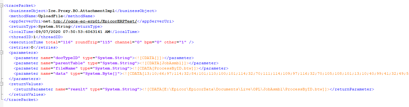

Use the Trace Luke.
Always my first port of call, but it doesn’t seem obvious to me how to correlate the trace log inputs to the example REST Inputs?

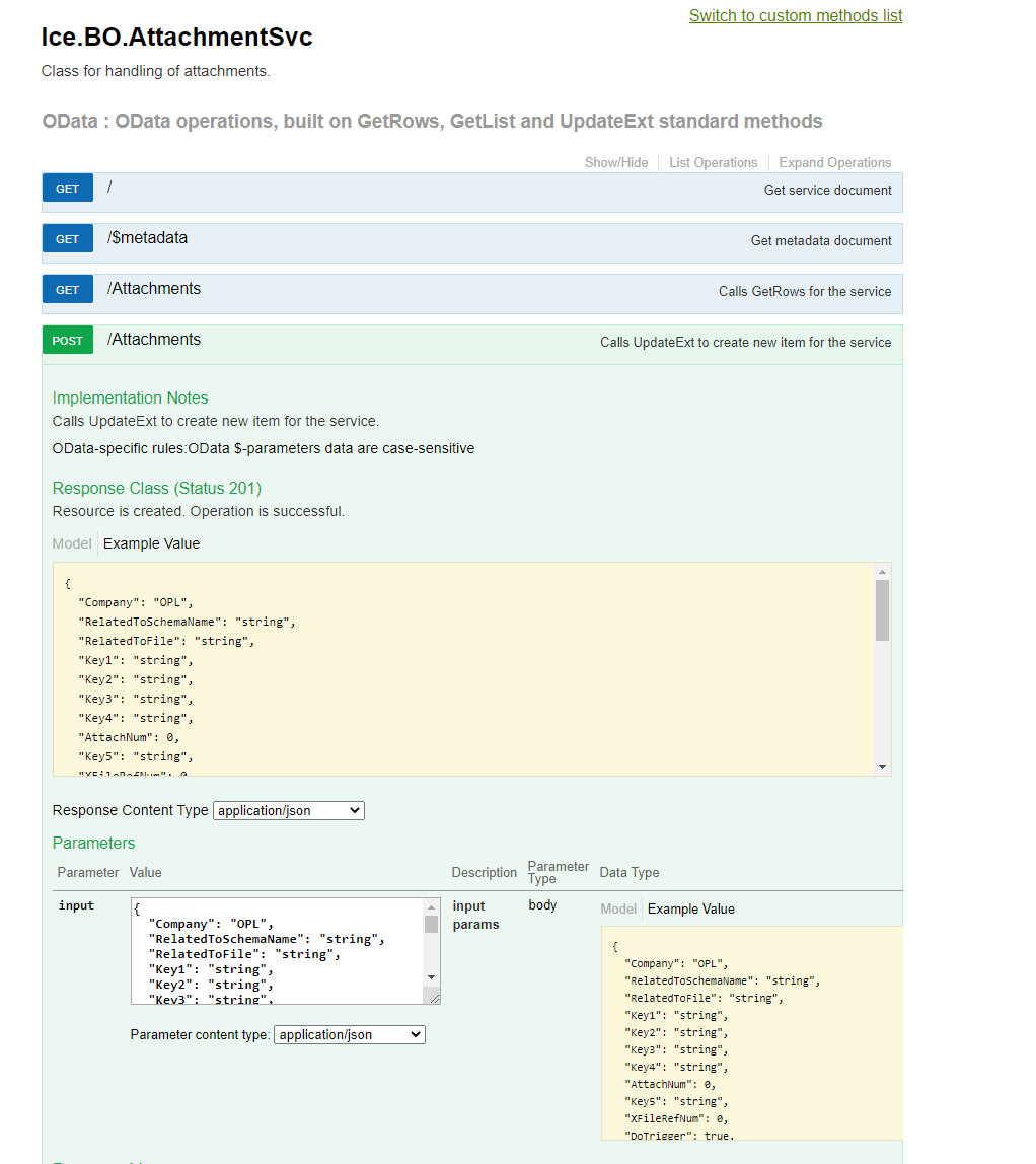

You need to switch to custom method list in the REST help, see the link in top right corner.
Basically you upload file using that UploadFile method, then you can use POST /Attachements to add /update record in XFileAttach/XFileRef tables, where reference to the uploaded file is stored.
