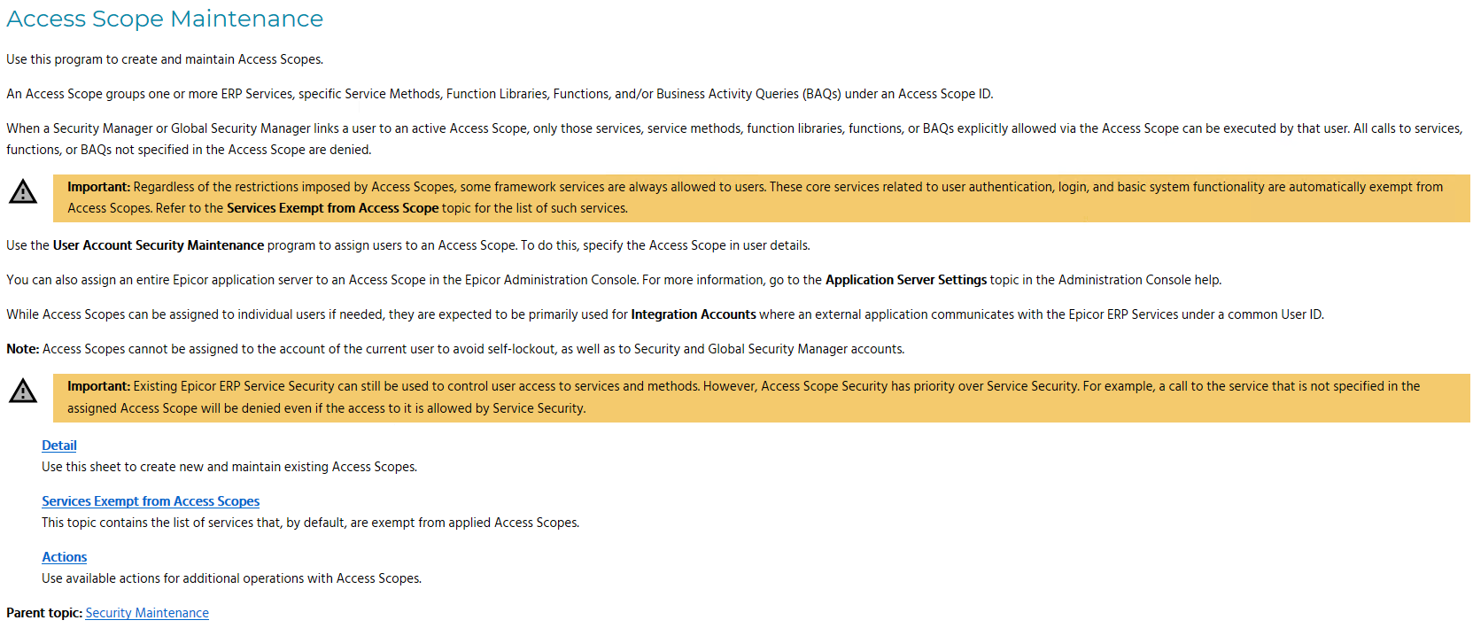

Just FYI, I believe as of 10.2.400, there is now available something called Access Scope which “groups one or more ERP Services, specific Service Methods, Function Libraries, Functions, and/or Business Activity Queries (BAQs) under an Access Scope ID.” You can then apply this Access Scope to a user and only allow them access to those items above that you’ve added to that group.
I’m sure it would be too much work to build one for someone that you want to give access to everything except Finance Modules. But this has been pretty nice to use on Integration Accounts for external applications that use REST to connect to our Epicor DB.
Maybe it would be nice if Access Scopes not only allowed access but could also deny access for whatever was added to them too…
Have to give credit to @Chris_Conn for introducing us to this feature.
