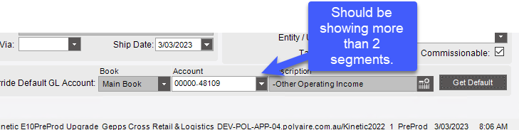

I am now doing it again this time in 2022.1 and for some reason when entering a Misc AR invoice and running the edit list, the account recap is showing the old chart not the new.
Have I missed something?. The customer does not have a GL control assigned to it. The Company has a default GL Control for AR, and I can see both books with account contexts set.

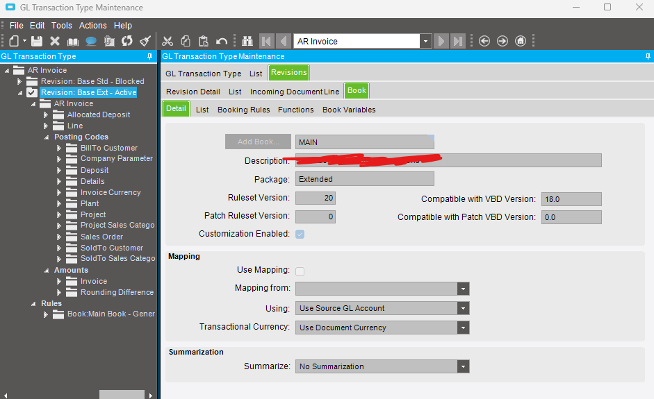

@Hally in the GL transaction type screen what is set on the transaction type for book?
Is that the book you want to use?
This is a tricky subject. You actually need to either use multi-book, and/or create a new primary posting book.
Where you get caught up is some transactions – primarily related to POs, Open AP and Open AR – actually look to a previous transaction to identify the GL account to use for the transaction. So if your AP Trade GL account on an open payables does not exist in the new book, you will get an error when trying to post a payment.

Hello @gpayne No I haven’t looked at the PE log viewer, so that’s a good point. Although if I am in the invoice line and select default account. It still shows the old GL, and not the new, even though it is no longer the master chart.

What I ended up doing was import the standard GL Transaction Type/Posting Rule in and set the book to the new book. Now I see all the segments.
