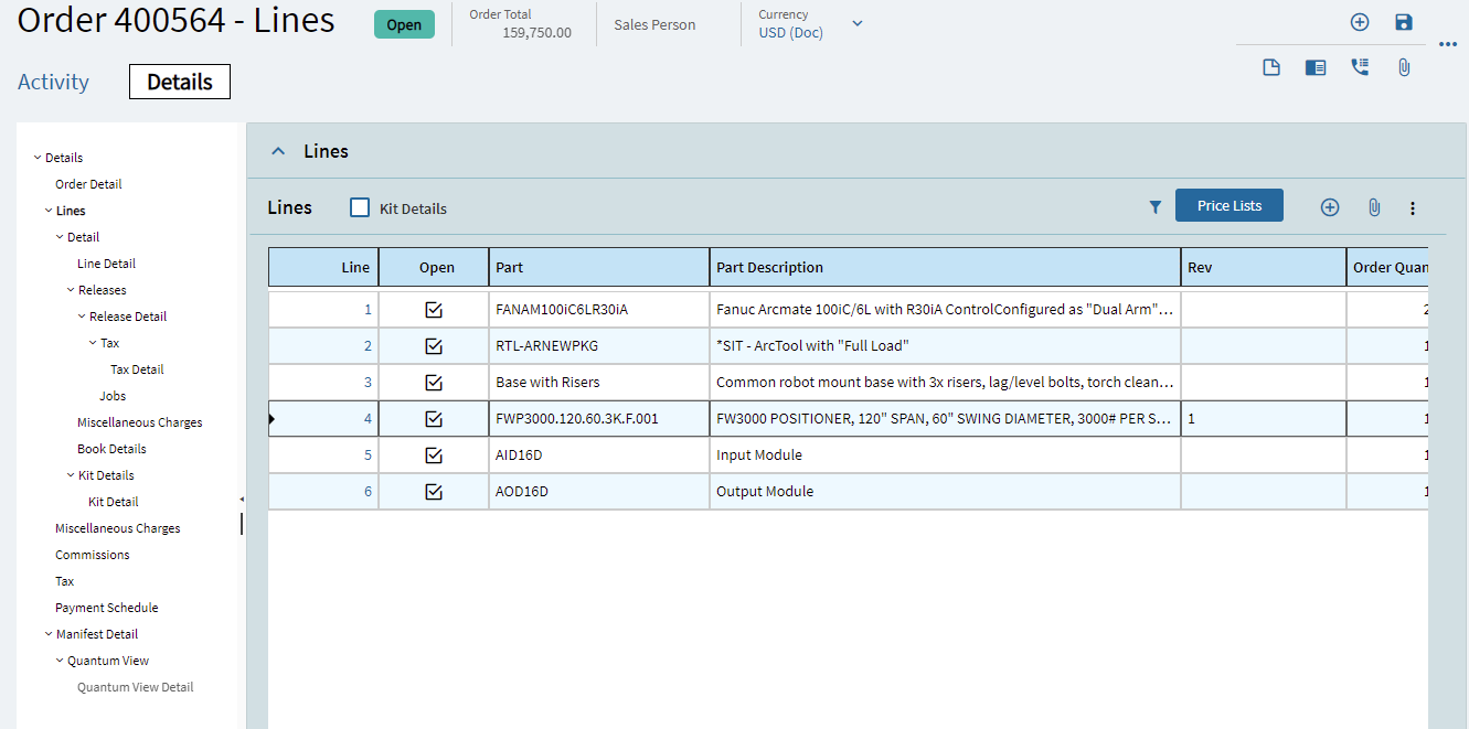

I have a sales order with multiple line items. One is a large manufactured item. A few line items are misc parts, one line item is service.
When I create a job from that sales order, I get a job for every line item. I don’t need a job for a spare part line item.
A job was not created for the large manufactured item because it’s a standard ‘part’ in our item list… it has a MOM, but it did not show up after I created a job.
When I create a job from sales order, I get the sales order number associated with the job number. When I create a job arbitrarily from the jobs screen, I get some random number and I don’t know if it associates with the actual sales order.
My question is - what is the correct way to create a manufacturing job from a sales order??? Do I push from the SO, or do I pull from the jobs screen???
Why does epicor put every line item into a separate job??? Why would anyone want this? In order to delete you have to delete the demand item first.
I could go into the first job it creates, and modify it so that it has what I want, but the demand item isn’t correct because it’s linked to the SO

When I create a job from this SO, it creates a job for every line item shown here. That’s insipid.
Ok, then my recommendation would be to use Order Job Wizard to create your jobs. You can select which lines need a job and create them there. It is a fairly simple process and you should be able to use the help, but if you need anything, let us know.

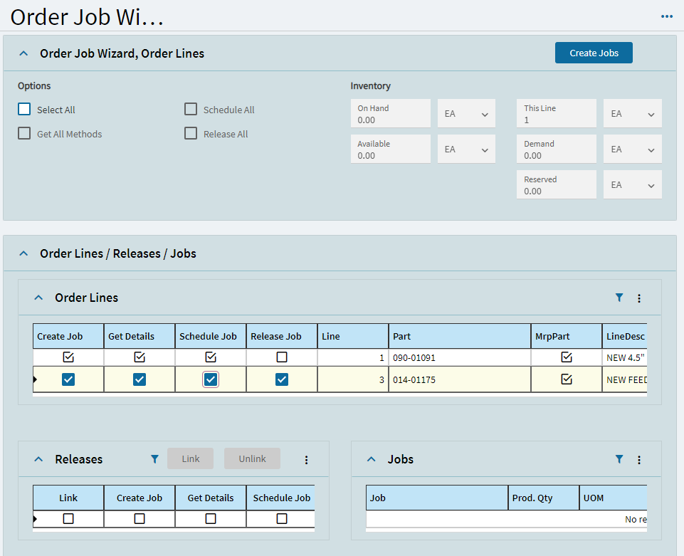

When creating jobs from a Sales Order… you can use the Order Job Wizard:
In the example above, my Sales Order has (3) lines… (2) of these lines are “Make”… the other is a stock item. This is why only Lines 1 & 3 appear in the Order Job Wizard.
You then check the boxes in the middle for what you want to do with each Line… Create Job, Get Details, Schedule, Release.
When ready, click the “Create Jobs” button at the top of the wizard… this will create the requested jobs, and again, based on your settings in Company Config, they will either get job numbers based on the “Next Job” number generator… or they will get job numbers based on the Sales Order Number - Line - Release.
IF you create a job in Job Entry first… then you have to create the demand link to link it to the Sales Order afterwards. In this case, the job number can be “the next job number” if you click the “next Job” button… or you can enter anything you want (manually use the sales order number if you wanted).
But again, if you do this, you then have to go into the job’s demand and add the link if you want it tied to the Sales Order Line/Release.
