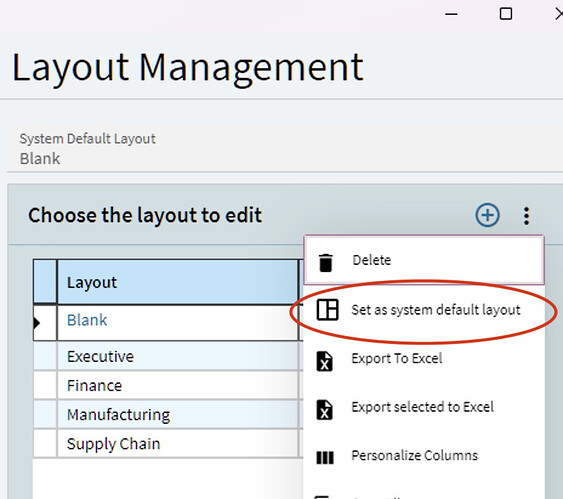

I don’t think you can force it per se, but for those that haven’t changed anything, you could set that published layout to the default (we just recently changed how we wanted the default to look, so I’ve been looking at this)
I don’t think this will let you overwrite anyone’s actual changes, but it did seem to work for us for those that haven’t made any changes.
