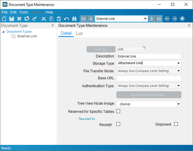

Now I want to send that information to Epicor to attach to the ShipHead for a specific packNum via the REST API. I’ve created a an attachment link docType in Epicor for this purpose.

So you’re wanting to use a link attachment correct?
