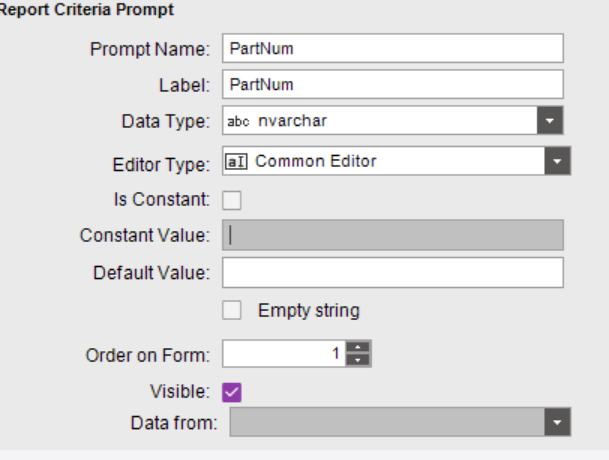

When I test the BAQ in the BAQ Designer, it works as expected, basically returning whatever value I throw at it. So, I created an RDD, added the BAQ, created the Criteria Set and generated the Criteria Prompt. I went into Report Style and created a report and style, set up the data definition, location, criteria, etc., and then went to test it…
Ice.Baq.Hierarchical.ValidationException: Mandatory parameter values
     are not specified for 'F1500303' BAQ: PartNum
How is that possible? There is the Criteria Prompt in the RDD.

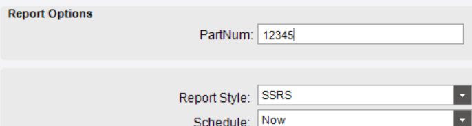

And here is the report screen…
Am I forgetting something here? I feel like there is a step that I am simply forgetting.

To resolve this issue, make sure your control name value is assigned within the Report Criteria - report mapping grid
ReportMapping_ControlName
