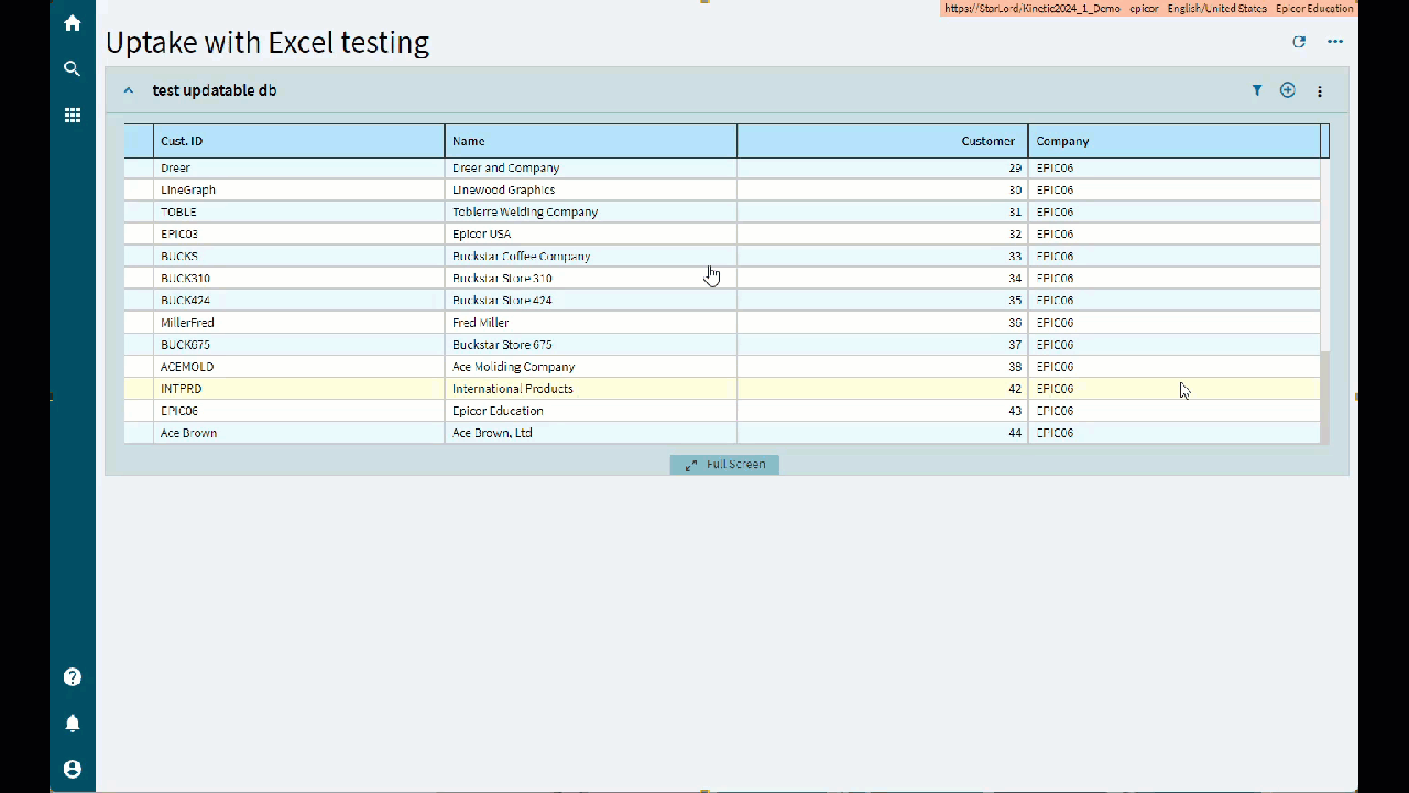

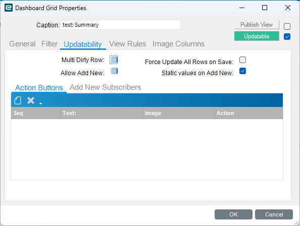

How did you enable the “Uptake from Excel” functionality? Is it available in Kinetic? I have a uBAQ for UD06 as well. I created an updatable dashboard in App Studio and made the grid and columns updatable. I can do a Paste Update but there’s no Paste Insert, Paste New or Uptake from Excel option. Paste New is not disabled in grid properties and I did check “Allow New Record” in the uBAQ.
Thanks. I created a Classic dashboard and it has the Uptake from Excel option in the Actions menu. Anyone know if this is available in Kinetic? I’d be happy with Paste New or Paste Insert too–anything to do a mass insert into a grid.
Just checked 2023.2 and no there does not appear to be any function. Did a simple copy paste with 3 rows on the customer table and it was pretty quick.
It may well be that they deemed in not necessary. Although just being able to select a file is less prone to error.
Planning on doing an install of 2024 in the next day or so I will retest.
This just in … there is an existing problem for this, PRB0283190 Kinetic NewUI – Grid view Paste > New no longer available (In Release Planning). Form - EpicCare (epicor.com)
And another one: PRB0268191 - Kinetic Dashboard applications are not providing the Uptake from Excel actions for updatable dashboards (Accepted - Not Yet Planned) Form - EpicCare (epicor.com)
