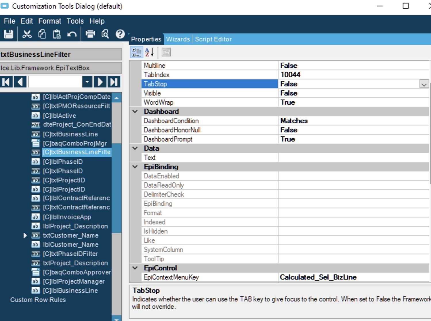

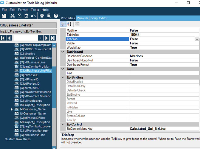

Ok, there are 2 pieces involved in the example. The first is the text field that people see and enter data into. It is NOT part of the selection directly: (txtBusinessLine)
The second is the field that actually drives the selection: (txtBusinessLineFilter)

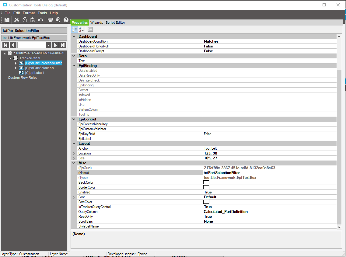

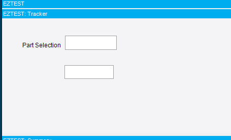

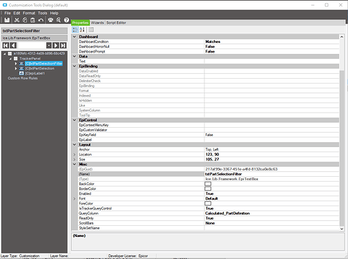

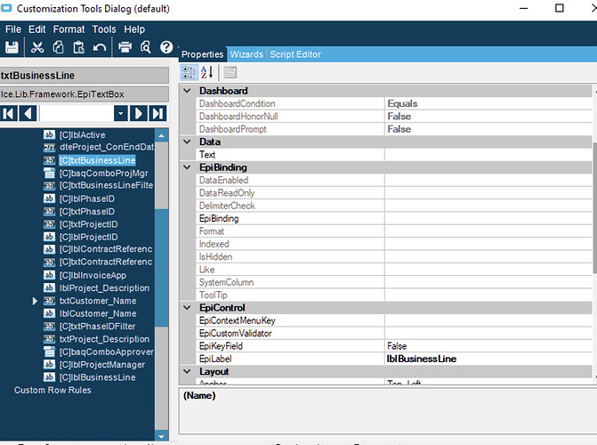

This is just a random dashboard I made to text this out.

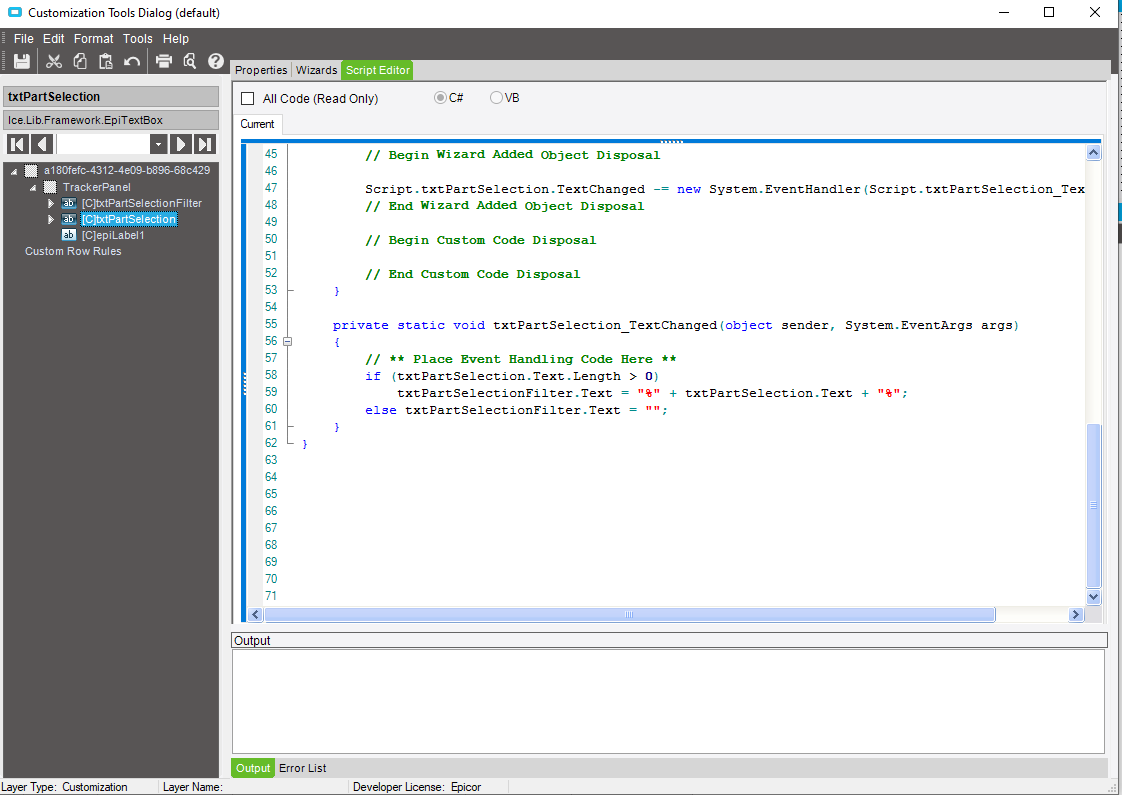

I made a calculated filed in the BAQ to group by different part numbers. For example, if part numbers end with “AA”, then customer A. If part numbers end with “BB”, then customer B. Or if a part is a retail or non retail part… On the dashboard, I have made two Textboxes, one is for entering date, the other is for filtering the grid.

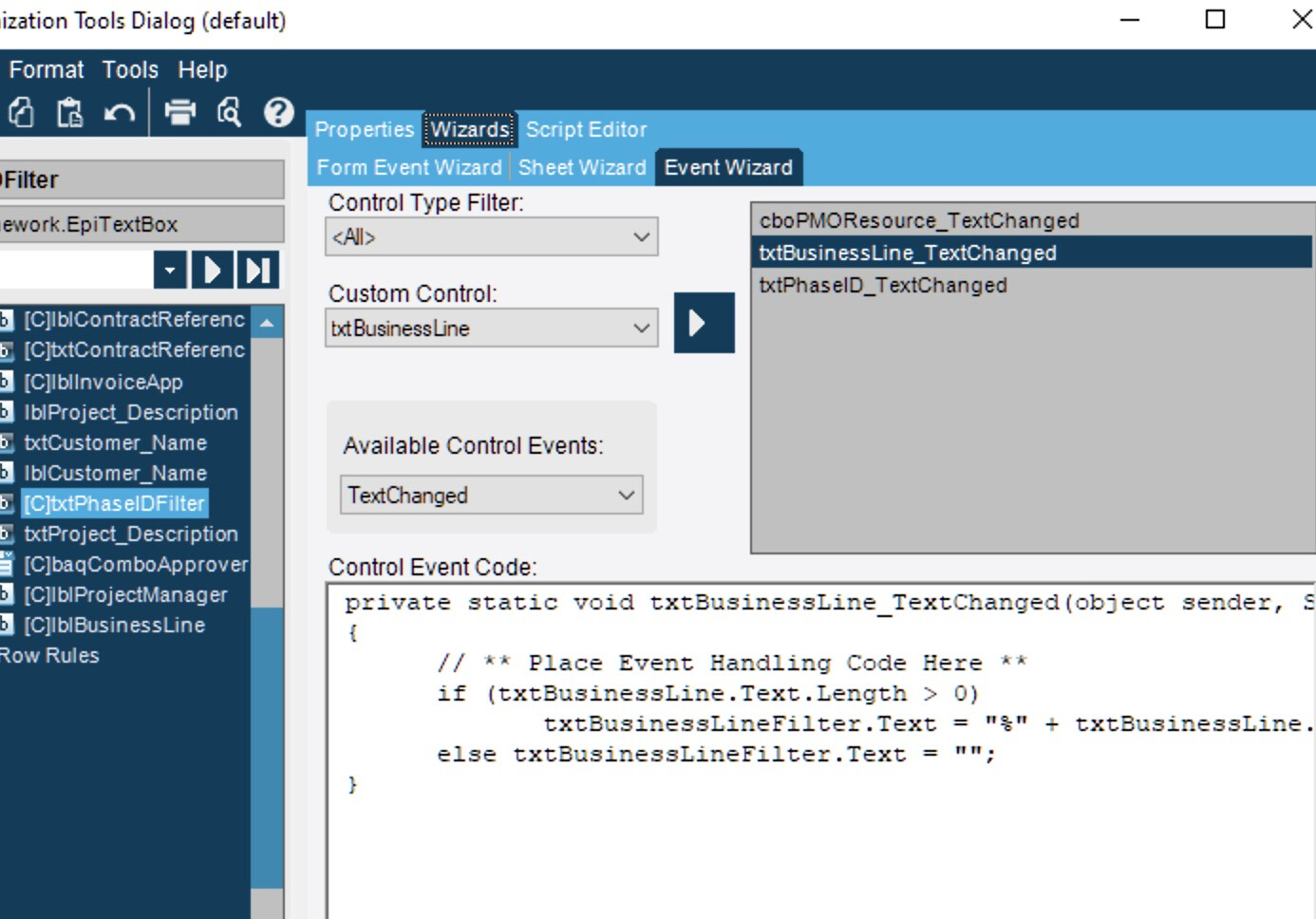

So, how to tell my second textbox (filter data) to grab value form the first text box (enter data)? Do I need to set another TextedChange event on the second textbox?
Here’s my code and the properties setting.
