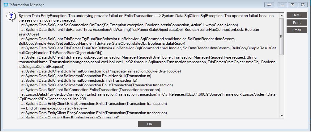

Dear Team,
While creating AP invoice line details from UD table i am getting below error , Kindly inform how to resolve .

because of For Each i think error is coming , kindly inform how to resolve,
Use this
using (var txScope = IceContext.CreateDefaultTransactionScope())
foreach (var ud12_iterator in (from ud12_Row in Db.UD12
where ud12_Row.Company == Session.CompanyID
select ud12_Row))
ud12 = ud12_iterator;
Erp.Contracts.APInvoiceSvcContract bo_ApInvDt = null;
bo_ApInvDt = Ice.Assemblies.ServiceRenderer.GetService<Erp.Contracts.APInvoiceSvcContract>(Db);
var bo_ApInvDtds = new Erp.Tablesets.APInvoiceTableset();
if (bo_ApInvDt != null)
bo_ApInvDt.GetByID(VendorNum, APInvoiceNum );
bo_ApInvDt.GetNewAPInvDtlMiscellaneous(ref bo_ApInvDtds, VendorNum, APInvoiceNum);
bo_ApInvDt.ChangePartNum(ud12.ShortChar11 , ref bo_ApInvDtds);
bo_ApInvDt.ChangeVendorQty(1, ref bo_ApInvDtds);
bo_ApInvDt.ChangeUnitCost(uCost, ref bo_ApInvDtds);
					var ttAPInvHed_xRow = (from ttAPInvHed_Row in Db.APInvHed
					where ttAPInvHed_Row.InvoiceNum == APInvoiceNum
					select ttAPInvHed_Row).FirstOrDefault();
					if (ttAPInvHed_xRow != null)
						var ttAPInvDtl_xRow = (from ttAPInvDtl_xRow1 in bo_ApInvDtds.APInvDtl where ttAPInvDtl_xRow1.RowMod == "A" select ttAPInvDtl_xRow1).FirstOrDefault();
						if (ttAPInvDtl_xRow != null)
							ttAPInvDtl_xRow.Description =  ud12.ShortChar17;
							ttAPInvDtl_xRow["Number06"] = ud12.Number06;
							ttAPInvDtl_xRow["Character05"] =  ud12.ShortChar15 ;
							ttAPInvDtl_xRow.DocExtCost = 500;
							bo_ApInvDt.UpdateMaster(ref bo_ApInvDtds, GroupID, "APInvDtl",true, false, true, false, out grpTotalInvAmt, out requiresUserInput, out opMessage, out opMsgChkBankRef, out opChkRevMsg, out lEnableGenLegalNum, out lUpdateRan , out opMessage1);
