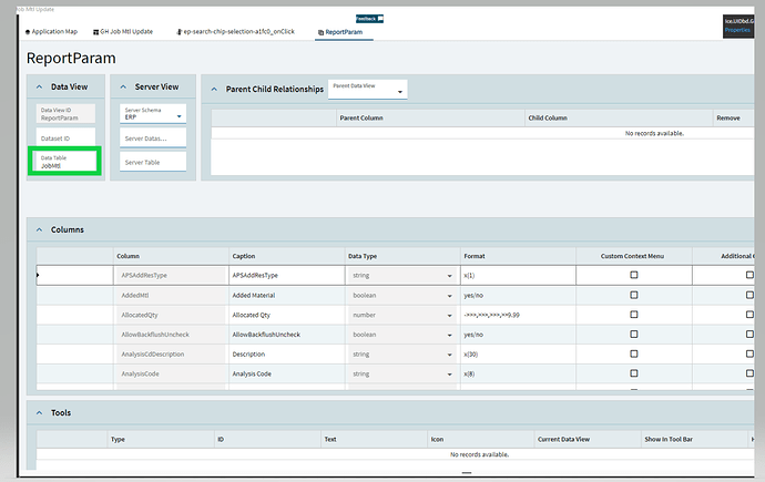

I’m trying to create a search chip on a dashboard to filter my BAQ based on a list of ‘Job + Assembly’ that a user selects. However, the search chip turns gray and unclickable when I preview the dashboard.
The EpBinding field is coming from my ReportParam dataview, and the data table is JobMtl.
Any ideas on what I might be doing wrong? Maybe I need to create my own data table for the search chip instead of using an existing table?
