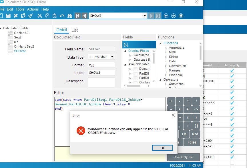

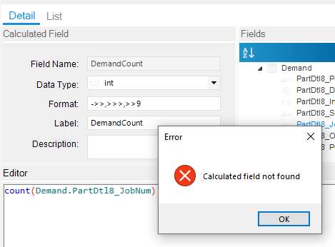

I changed the query for data on column A to “issummary” flag, however I am not sure how to create the calculated field for the count. I keep getting below error when checking syntax. I haven’t had experience with the summary feature… .
You can’t use a reserved word for your field name. Try MyCount or something else.

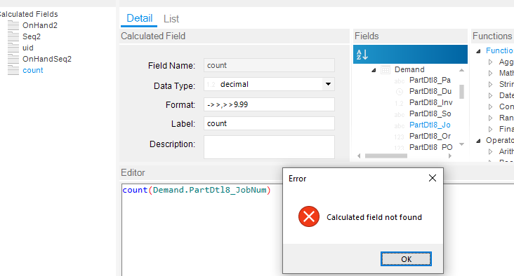

True, thanks. I changed it but that was not the issue. Same error.
What about changing the data type from decimal to integer
Same issue.

sum(case
when x = x then 1
else 0
end)
It needs to be contained in either an aggregate function or the GROUP BY clause though… I’ve used the ‘over’ clause to partition and order items before, but can’t figure out what clause to use here.
That is why I put the SUM before it. Am I missing something?

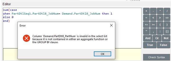

This is the error I get whenever I use SUM our COUNT by itself.
Can you not group by partnum?
I had nothing grouped. Even if I did group by that column, I would keep getting error until all columns are grouped. Once I group all columns, I get this error instead:

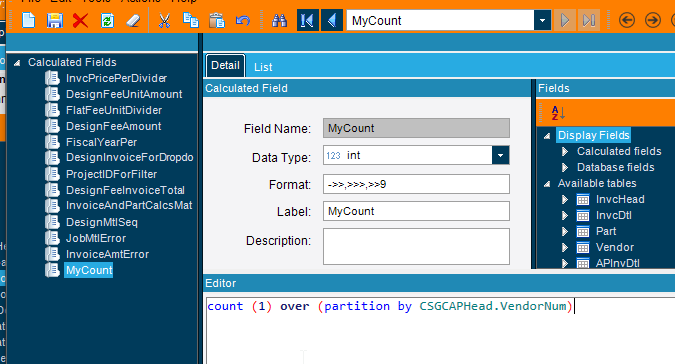

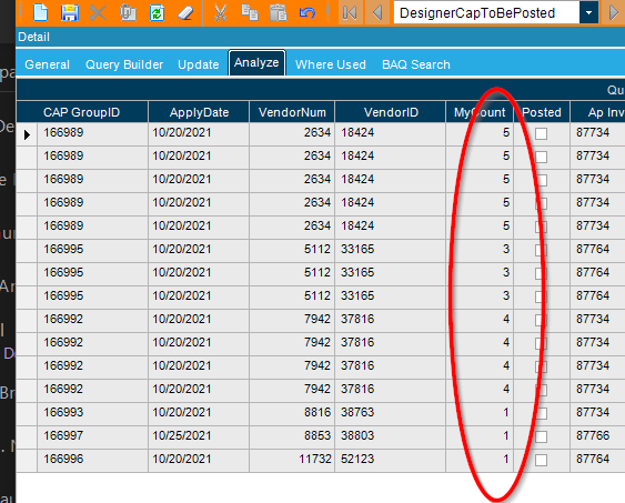

I think you can just do this. (you need to uncheck the group by boxes in the field selection)
Count(1) over (partition by field1, field2, etc)
This will do the “grouping” without actually grouping the rows.
Banderson, you are correct. Thank you. I created a subquery to count JobNum(columnA) instances and then joined them on a top lvl by JobNum to the table with Column B data. I was trying to avoid having to do this workaround, but appears that this can’t be done in the calculated field editor alone.
