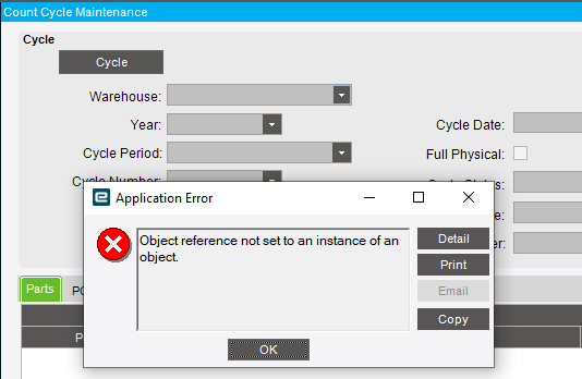

I’m getting this error in Count Cycle Maintenance after selecting a cycle. Any ideas on how to trace down the offending field/record?
I’ve tried many things, got a case going with Epicor but so far no luck… Thanks in advance.
Client error:
Application Error
Error Detail
Correlation ID: 22be7784-f750-4008-9ea8-3ab898ff5640
Message: Object reference not set to an instance of an object.
Program: Epicor.ServiceModel.dll
Method: ShouldRethrowNonRetryableException

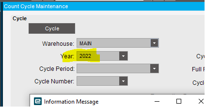

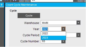

Thanks Pete. So I just noticed something - it first tries to load cycle counts from 2022 (there are none), it errors out, then loads 2023. Anyone know where is this errant year might be coming from?
My other site doesn’t have the 2022 option and works fine.
Found it. There was an incomplete physical count from prior year, hidden unless you checked the box during search.
