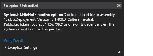

We are finishing our move to Azure and I am now bringing over custom code and have changed the directories of the files that are being swept into epicor by our external code. I can build the project just fine but if I try to debug it I am getting this:
I checked the directory and all .dll files are present and the install is the same version of Epicor we are currently live on. Kind of at a loss here.
