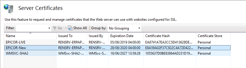

Check certificate in ERP app service. certificate for the ERP app service should contain exactly this hostname that error shows, in subject or subject alternative name.
Thanks, please let me know how to check this?
Certificate is set up in IIS settings.
Another possibility – if you use self-signed certificate for ERP, you need to import it on the client machine certificate storage. Client machine is in this case where ESC is installed.
Thanks @Olga there are two files which show as expired and I checked the hostname which is correct only.
No client machine we are directly placing the CSV in the folder on the server.
Thank you @Olga, I fixed the issue and its working fine now.
