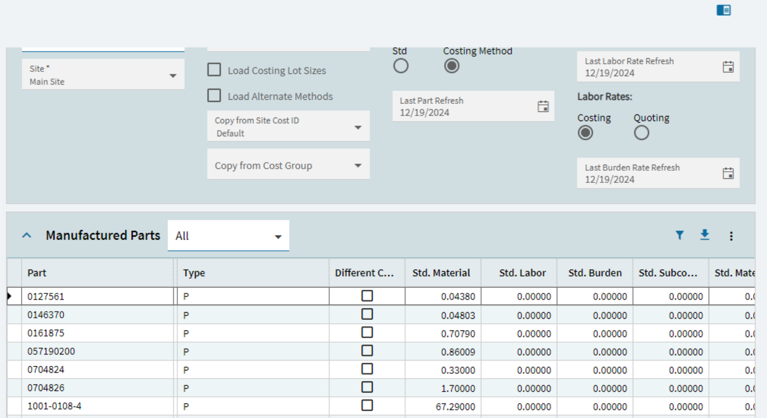

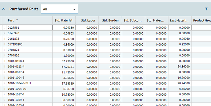

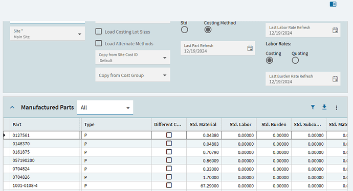

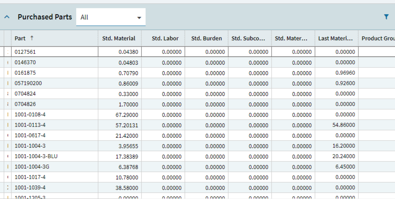

We want to perform a cost roll-up to calculate the average cost for parts. When I load the cost details, the purchased parts are displayed in the manufacturing section.
Purchase part section also same part displaying
I wanted to do the cost-roll for average cost parts
Interesting - I’ve never had purchased parts appear in the manufactured parts tab. If you spot check a few of them, are they purchased in one site and manufactured in another? Or possibly your purchased parts have methods - there is a checkbox to exclude methods on purchased parts.
As for rolling average costs, Epicor has a fairly complex formula for doing this. It’s almost like a weighted average. I’ve had situations where we wanted to change the average cost due to unusual circumstances (like a prototype at a very high cost). We’ve always handled those through individual cost adjustments or with a DMT.

The only thing that separates the purchased parts from manufacturing in that group is the UI and the grid filters.
If you look in the database, they are all in the same table, same group.
So it’s just a UI issue. The rolling and what not should all still work.

This is very helpful, thank you. Yes, this is a grid issue. As per your recommendation, I switched to the classic view, and now only the manufacturing parts are displayed. I will be reporting this to Epicor.
