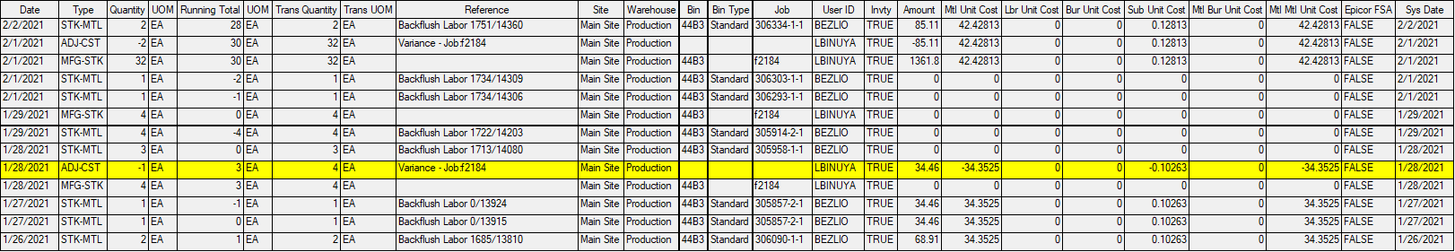

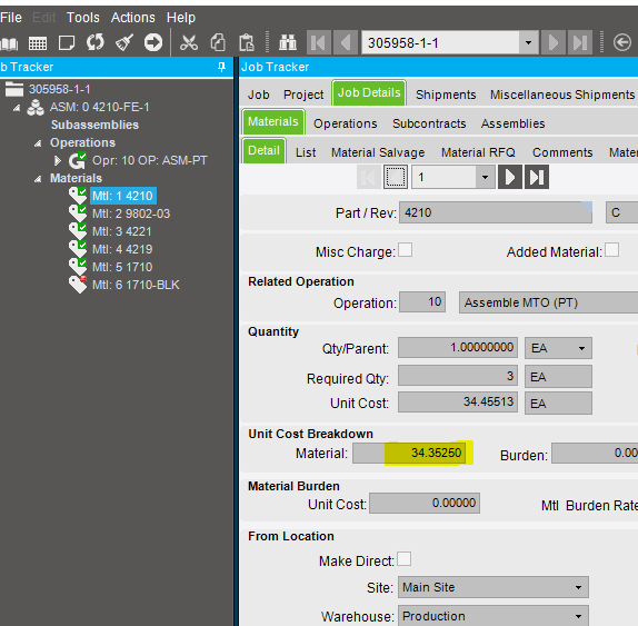

There were STK-MTL transactions at zero cost on 1/28 and 1/29. Job materials had costs.
The cost will still be there, but the weighting should be zero, meaning the next receipt will override the existing value.
So the MFG-STK transaction on 2/1 that recorded the receipt from the job to stock was the trigger for updating the avg cost in the part trans table? Why did MFG-STK transaction on 1/28 change cost to zero? The ADJ-CST on 1/28 made the cost go negative - why?

This is because the MFG-STK transaction of 4 on 1/28 is at zero cost. Since there was no qty in hand before that the new average cost becomes zero.

Because the avg cost before that was not zero. The mfg-stk transaction came in at zero cost. So the system did an adjustment to change the avg cost in the system to zero which can only by done by making a negative adjustment.
