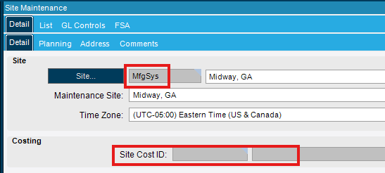

We did some testing today and I am puzzled with the cost site id not on one of our sites. We have a Cost ID (the default) setup on site MfgSys. When I look at the Plant.PlantCostID field it is blank. All of our other sites have a cost id on them. This makes me wonder how the cost in MfgSys are correct (which they are)?
There is a datafix for that and it is also possible that you have some PartCost records without an id.
Thanks Greg. I will see if I can find the fix. Also, did a quick query and I did not find any records missing the cost id.
My main mfgsys is also blank in the plant table.
I put a ticket in with Epicor. I have to provide some data to them and they build the fix specifically for our situation.
I guess I should do that too then, it doesn’t seem to be a problem, all the variances and what not are calculating off the default cost ID.
