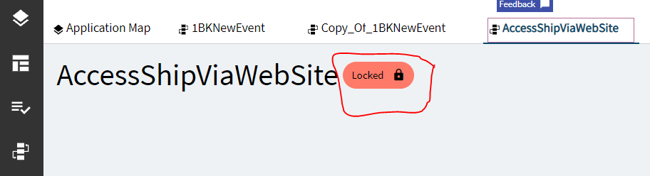

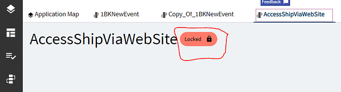

If I create my own event, I can Copy or Delete it, but for default events the copy does not work (it seems like if they are locked, they do not even allow the copy).

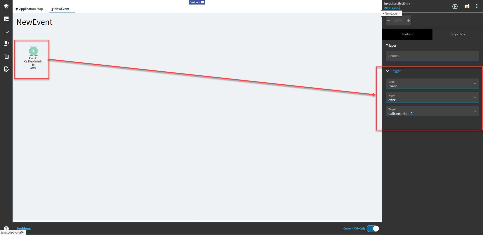

@josecgomez is correct. You should be creating a new event and set the trigger to:
  1. Event
  2. Before or After
  3. The event name you want to hook into.
You should not be modifying or copying stock events. If you try to do this and you upgrade, you’re going to have a bad day.

Base events not being copy-able is a late breaking bug in 2021.2.3 which will be fixed in an early update (I believe we’ve got this fixed in 2021.2.5 though it may have made .4). We realize that there are a couple of education courses that tell you to do this and lead right into the issue.
The story here is that both things are true - We are not allowing editing base events (without the sdk) because doing so makes layers that will not automatically merge together on upgrade when base event logic is changed and most customizations can be done instead by hooking custom actions before/after base events instead. If you previously had edited a base event directly we leave the event open for editing so if you’ve already done so it will continue to work, but may be more effort for you maintain.
However, that does not mean copying a base event should be restricted and we’d not intended for that to be locked down if you want to copy/reuse some of the logic for another event.
