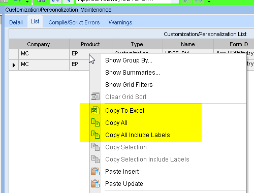

So continuing on the testing/upgrading process. from 10.1.600 to 10.2.400. I’ve just tried to do a copy to of the list of customizations to excel. Thinking it was a the O’le Copy to excel bug raising its head, but I can copy to excel from any other dashboard, or search results.
I tested back on our 10.1.600 install and it works, so just putting it out there if anyone else on 10.2.400 is experiencing the same issue.

Does “Copy All, Include Labels” work?

I was referring to about the actual list in the Customization Maintenance form. Pardon my ignorance, but surely the data in standard form grids get updated during the upgrade? I actually thought the grids pull from either code a (dynamic query) or a defined BAQ?

Whoops … I missed that you were referring to the built-in grid in the Customization Maintenance.
For what its worth … the options are in 10.1.400.23
I’ll be installing 10.2.300 this weekend, and test on that for you.
Funny. I just blew my 10.2.300 install away this afternoon. Logged a case with Epicor. They are saying it is an issue, but am waiting on a problem number. As soon as I get it I will post.
Here you go there is a problem number for this PRB0209282. A fix for 10.2.400 is pending.
