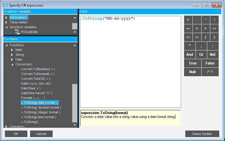

I want to convert a date field to a string value in a BPM widget. Fortunately, there is conversion function just waiting for me to use, just double click the function in the tree view and, viola, the function and format is placed into the editor…
Dang, that’s sweet! Now, all I have to do is add my date field to the formulas, right? Not so fast, bub…
Hmm, that does not appear to be working as expected. But this appears to work…
Perhaps the field I am referencing isn’t a date formatted field? Nope, that’s not it.
Certainly I could do this with a bit of custom C# code, but why should I have to?
What am I missing here?

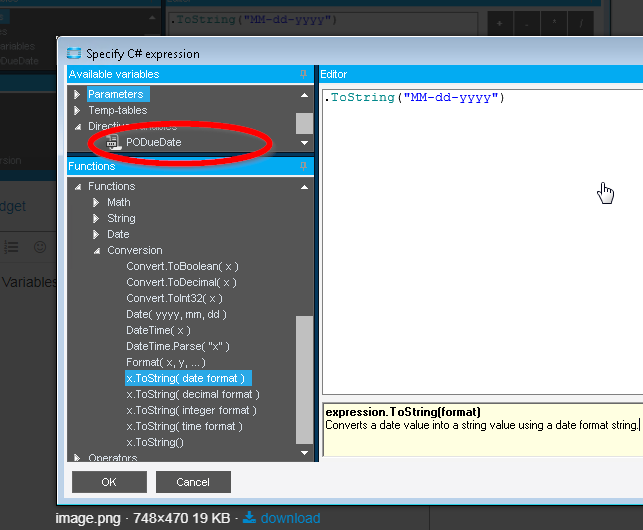

click on the PODueDate in the Directive Variables tree
Then add the .ToString... after it.
Also, the format param is not what you think. Search C# documentation for ToString(format) to get a list of valid format values
