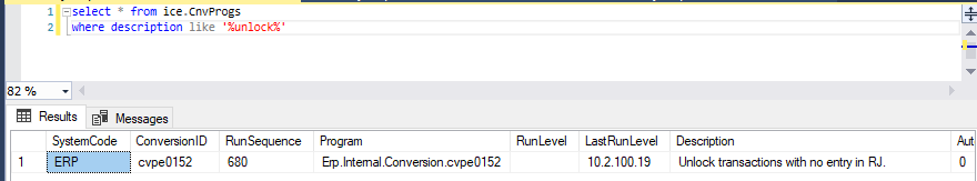

What Conversion unlocks the AR groups in E10? I know if E9 it was 10250. I can’t find it in E10.
Thanks Kim
Thanks Kim

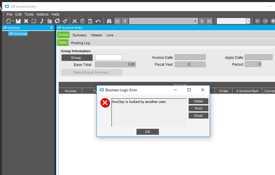

yes that is what I was looking for but this didn’t work for me. I guess I need to do have go in and close back out.
If you can’t resolve this, please open a support case and request the following data fix:
OF_Upd_InvcGrp_ActiveUserID
They would need the company ID and GroupID to generate the fix.
