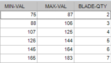

I have a simple configurator lookup table, a small snippet of which is below;
I have a value from the configurator, and what I want to do is; if this value is >= MIN-VAL and <= MAX-VAL I want to return the BLADE-QTY.

It is possible but you’ll have to write some code to do it. I would recommend writing a BAQ to show what the record structure is like for Configurator Look-Up tables for guidance. Each record in that table represents a table name, a row, and a column - basically a cell in the table. Once you filter for the table name, then you’ll search for the values for the columns you’re interested in. AND THEN, you use those values to find the column(s) for the blade qty.

Hi Guys, thanks for taking the time to reply, I do agree about the UD Tables but I am under strict instruction to use the Lookup tables provided. Any way, after spending way to long on this I eventually managed to get something that works. I realized (luckily) that I only needed the MIN-VAL value, as the first row where it is less than my BS() value is the one I want. I could not get anything to work with the two criteria.
