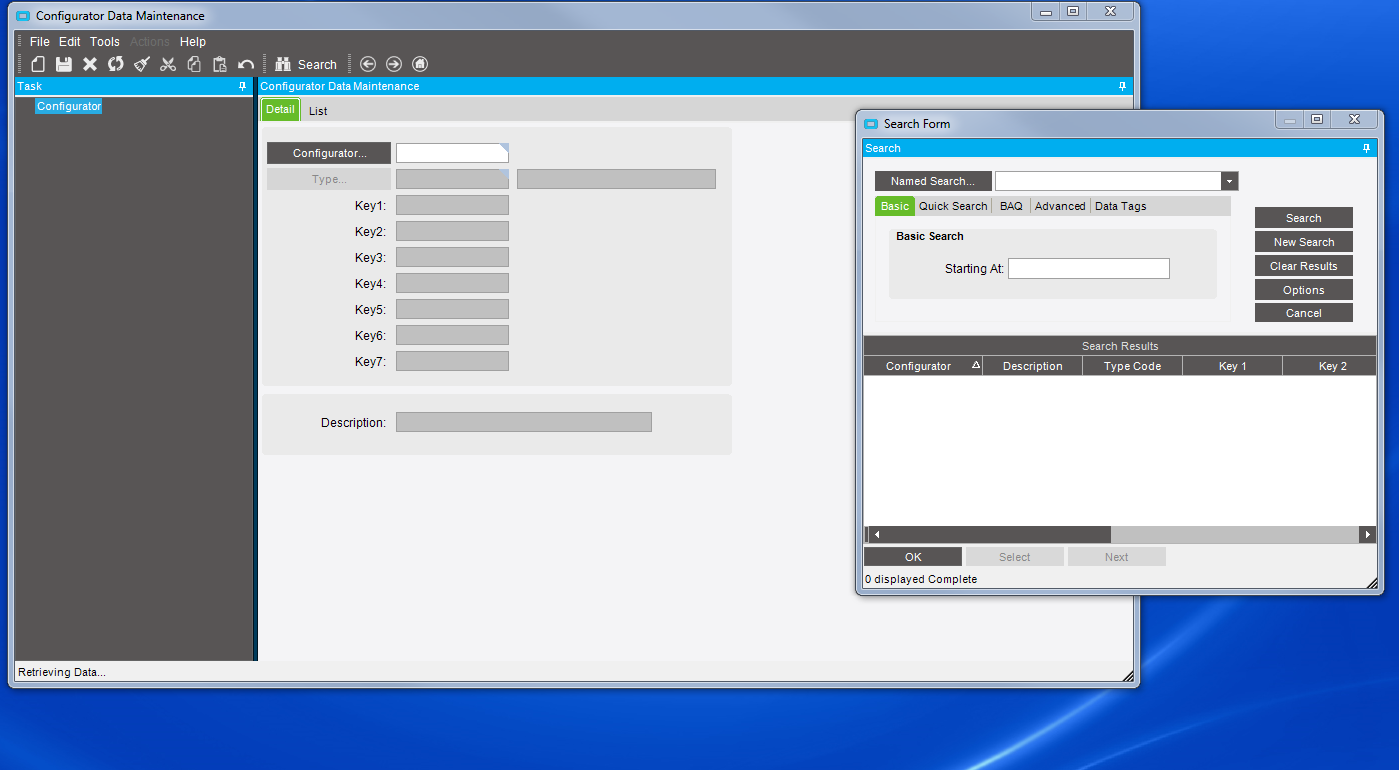

I think I found the right window, but when I press the configurator button and hit search none of my configurators show up.

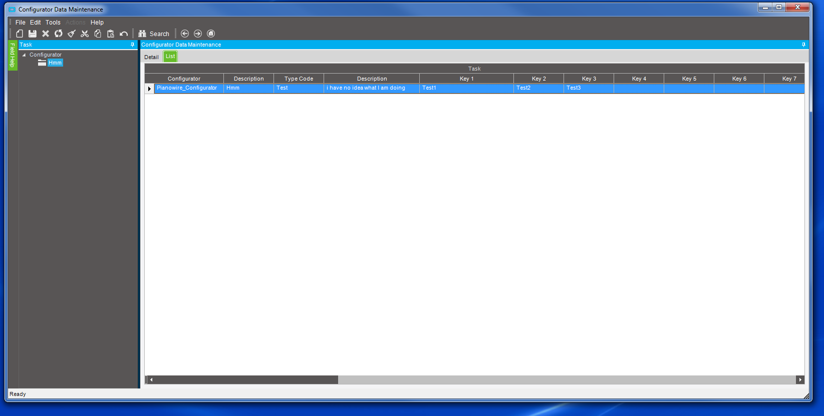

OK, I think I have created a row in the table, now how can I bind it to a combo box or reference it in a UD method?

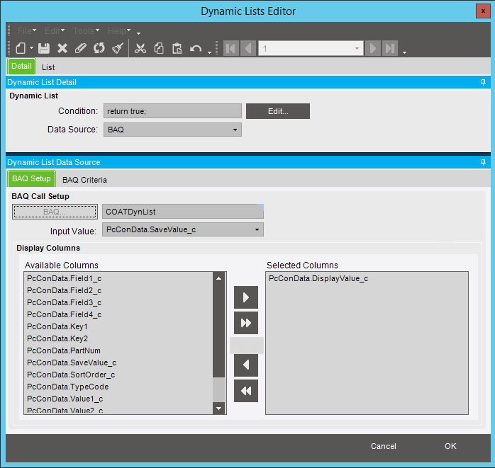

You can do something like this for combo box and use a dynamic list like this

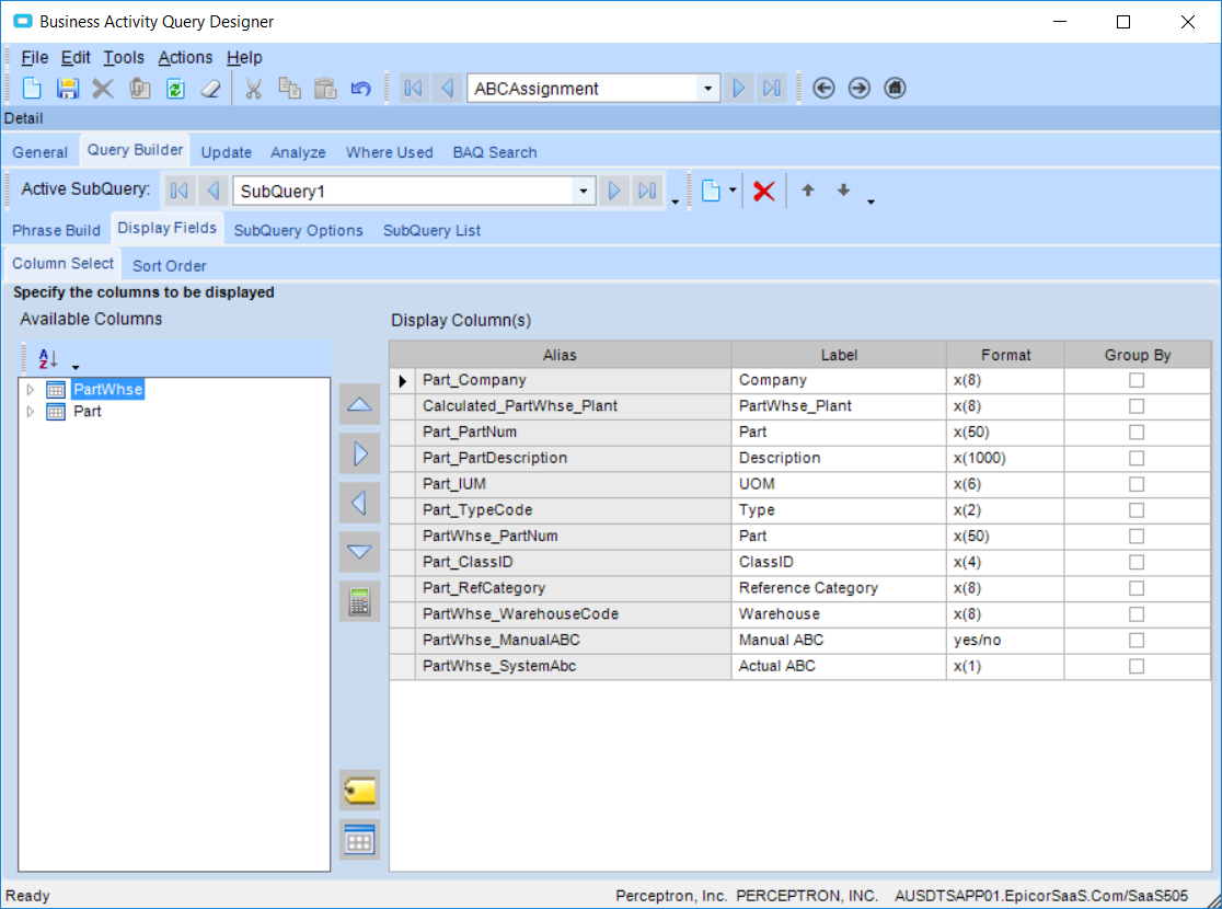

OK, I got access to the BAQ entry screen now. I have another question now though. How can I change the column labels and order in PcConData?
Hi Evan,
On the Query Builder | Display Fields tab, you can change the order of the fields and the labels.
Mark W,
Hmm, but can I change the columns names and order in the table themselves? Number01 isn’t a very helpful name.
I’m afraid not Evan.
