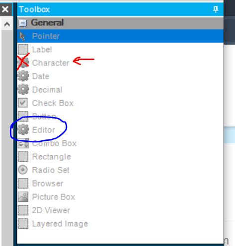

Are these inputs Character fields? The Editor field has an unlimited character count, I believe.
Tried making it an Editor field, but still getting the same result where it is limited when I print the report. And have confirmed with a BAQ that the PcInputValue.InputValue field is only storing 50 characters.
Thanks for the suggestion though!
