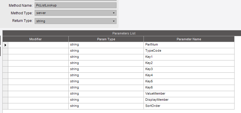

Would it be possible for you to share a screenshot of how you do most of your querying in ud methods? I have seen how you can return a string with certain delimiters from a UD method to a combobox to separate the value and display but not sure how I could do this without writing a function to construct the string. Do you do this a different way?
I pass in via parameters to the UD method the filtering criteria, how I want things sorted and what fields to pass back as my ValueMember and Display member.
StringBuilder MyList = new StringBuilder ();
// build whatever query you need and then loop through it
var query = (from r in Db.PcConData where r.Company == Context.CompanyID &&
r.PartNum == PartNum &&
r.TypeCode == TypeCode select r);
// more filtering and sorting goes on …
foreach (var line in query)
String test = line[valueMember] + "" + line[DisplayMember] + "~"; // value member is separated from display member by backtick character and each set by the ~ tilde
MyList.Append(test);
// at this point I could add some custom values that didn’t come from the query.
return ((MyList.ToString ()).Length > 0) ? (MyList.ToString ()).Substring (0, (MyList.ToString ()).Length - 1) : (“N`None”); // if the query resulted in nothing we return N, None
