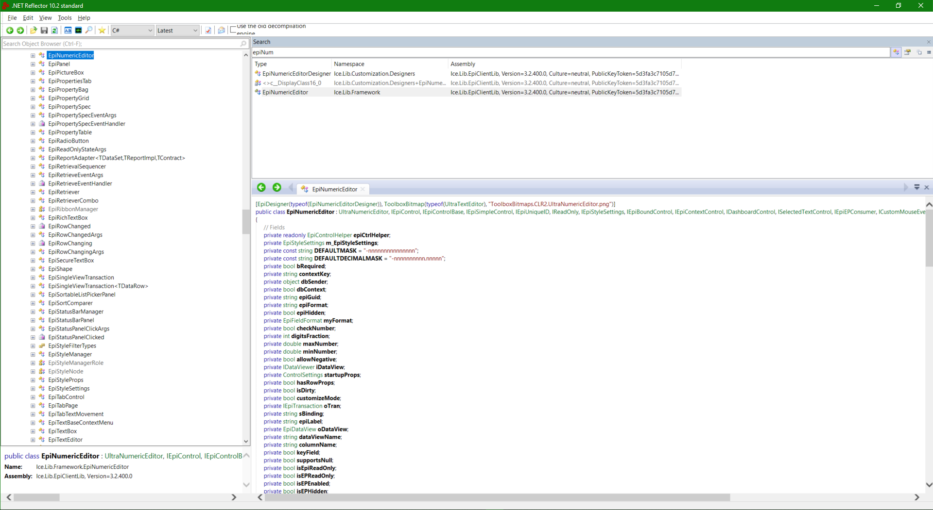

Keep getting CS1002 expecting a semicolon. I think it might be an incorrect control type (i think that term is correct)…EpiNumericEditor.

CS1061 - x:\Users\Me.Domain\AppData\Local\Temp\48\ConfigDump\Client\InspPlanInputEventCollection.cs (63,33) - ‘Erp.Shared.Lib.Configurator.InputControlValueBound<Ice.Lib.Framework.EpiNumericEditor,decimal>’ does not contain a definition for ‘value’ and no extension method ‘value’ accepting a first argument of type ‘Erp.Shared.Lib.Configurator.InputControlValueBound<Ice.Lib.Framework.EpiNumericEditor,decimal>’ could be found (are you missing a using directive or an assembly reference?)
CS1061 - x:\Users\Me.Domain\AppData\Local\Temp\48\ConfigDump\Client\InspPlanInputEventCollection.cs (63,79) - ‘Erp.Shared.Lib.Configurator.InputControlValueBound<Ice.Lib.Framework.EpiNumericEditor,decimal>’ does not contain a definition for ‘value’ and no extension method ‘value’ accepting a first argument of type ‘Erp.Shared.Lib.Configurator.InputControlValueBound<Ice.Lib.Framework.EpiNumericEditor,decimal>’ could be found (are you missing a using directive or an assembly reference?)
CS0117 - x:\Users\Me.Domain\AppData\Local\Temp\48\ConfigDump\Client\InspPlanInputEventCollection.cs (67,36) - ‘Ice.Lib.Framework.EpiNumericEditor’ does not contain a definition for ‘Inputs’
CS0117 - x:\Users\Me.Domain\AppData\Local\Temp\48\ConfigDump\Client\InspPlanInputEventCollection.cs (68,36) - ‘Ice.Lib.Framework.EpiNumericEditor’ does not contain a definition for ‘Inputs’
CS0117 - x:\Users\Me.Domain\AppData\Local\Temp\48\ConfigDump\Client\InspPlanInputEventCollection.cs (73,36) - ‘Ice.Lib.Framework.EpiNumericEditor’ does not contain a definition for ‘Inputs’
