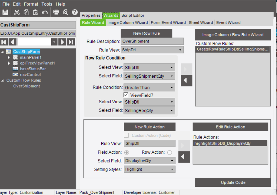

Do you mean on the form displayed in the Epicor client or on the actual printed packing slip?
If the first, then a Row Rule might work.
On the later, a Textbox can have its color set based on a formula. Typically you evaluate a comparison, and if it is true, the color specified will be used, else the false color will be specified.
like:
=Iif(Fields!ShipQty.Value > 10,"red", "Transparent")
Thanks Calvin. I’m looking to display in the form so I will review Row Rule.
Ahhh, press the update code button! Merci, think I’m there
