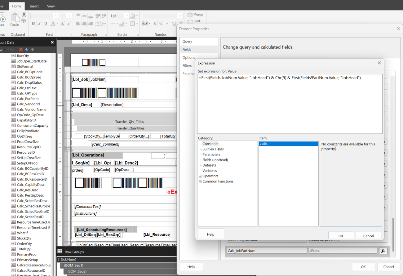

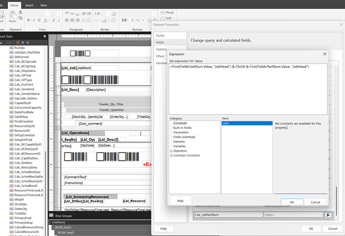

I’m trying to create a barcode concatenating JobNum and PartNum on our Job Traveler

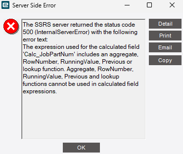

However, it’s giving me this error when I try to upload
I tried removing First prefix on the expression, removing the dataset reference but I still get this error. Please advise!

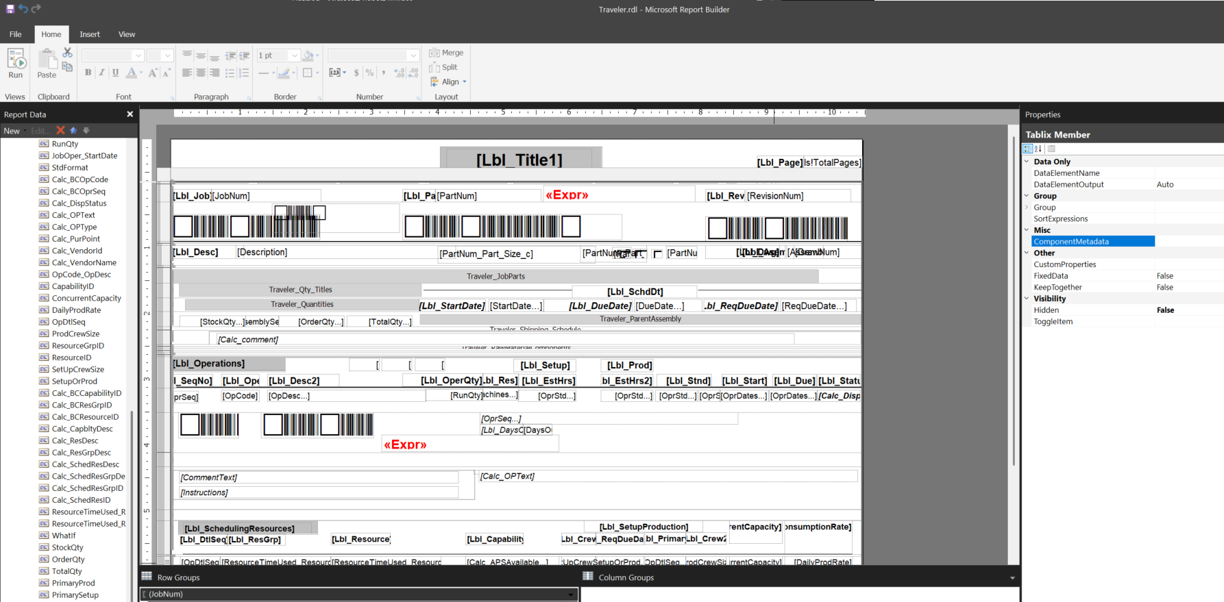

WHERE are you trying to place this barcode exactly? In the Header or Footer?
Right now, the header or body of the page. We’re running tests and this can be changed later; we just need the barcode to show
If outside of the Tablix you will usually need some Code to assist.

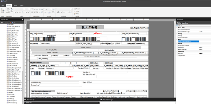

How can I tell from the Tablix Member if I’m outside of the scope? Thank you again for your responses
If you are in the header or footer or outside of the grid area you see highlighted in your image you would need some Code similar to this to update items outside of the Tablix:

My field in the image above is outside of the Tablix.
