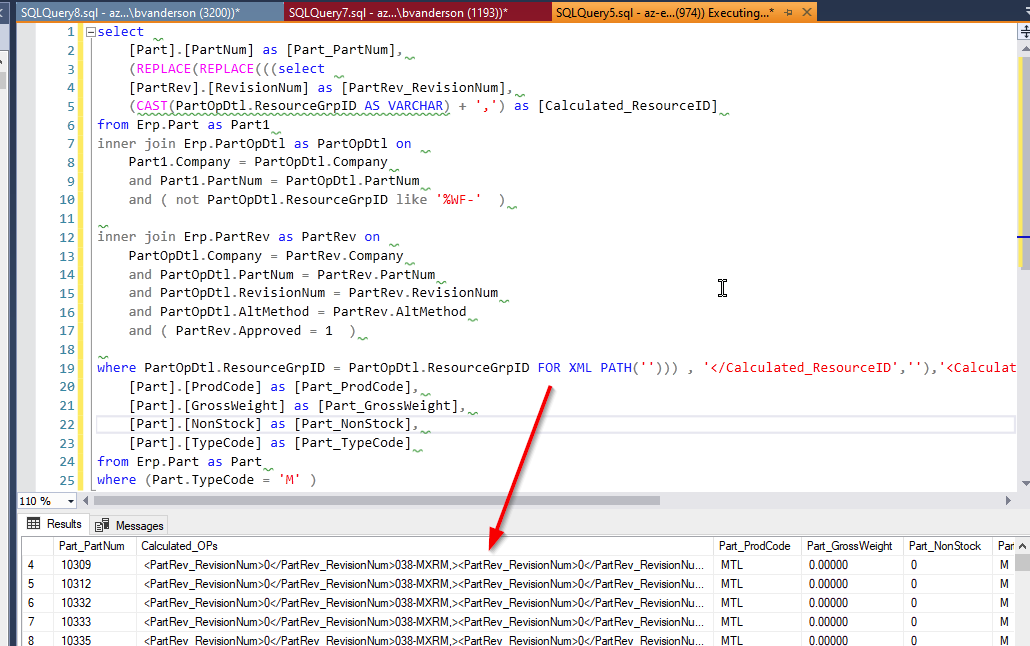

I tried making the changes to my BAQ that were shown in the example BAQ. This time it ran but I had to stop it because nothing happened, but I received some untrustworthy results
Anyway…here is the code - please note that I use the GUI interface to create the BAQ’s and add in the SQL when I can figure it out!

That error (where stuff doesn’t show up until you hover over it) happens when you have too much stuff in a single cell. You’re going to have to find a way to reduce how much is going into each cell.
If I strip out your custom stuff, this is what’s showing in that field. So it comes back, but you still have all of the XML stuff in there. You’ll need to do the string manipulation to get rid of all of that.
Keep in mind, the function FOR XML PATH() is used to take a query and make it XML for some other program to read (like a webpage or something). It shoves it all into one cell and adds the XML tags in it.
This really wasn’t intended to be used a concatenate function, someone just noticed that you could, with some string manipulation to get rid of the XML tags.
