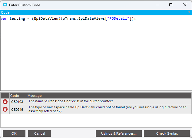

I am trying to create a dataview so i can pull in the extcost from the PODetail. I am getting this error. I do not see a reference that I am missing. I am wondering if my syntax is wrong.
You’re trying to use client code on the server.
Whole different ballgame.
so there is no way to do it then?
Yes, you’ll just have to take a different approach.
Explain in detail what you want, and one of us can point you in the right direction.
