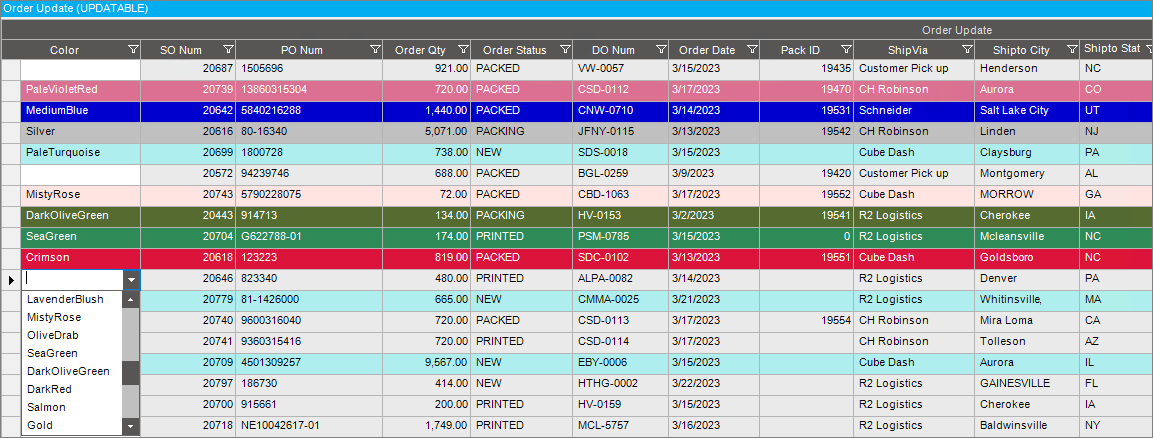

One of our customizations in the Smart Client uses an updatable dashboard and custom row rules with ControlSettings(). Is it possible add to a code block anywhere in App Studio?
Here is a sample updatable dashboard.
// Description: PaleTurquoise
ControlSettings myCustomSetting = new ControlSettings();
myCustomSetting.BackColor=System.Drawing.Color.PaleTurquoise;
myCustomSetting.ForeColor=System.Drawing.Color.Black;
Nope.
You’re SOL with that one.
