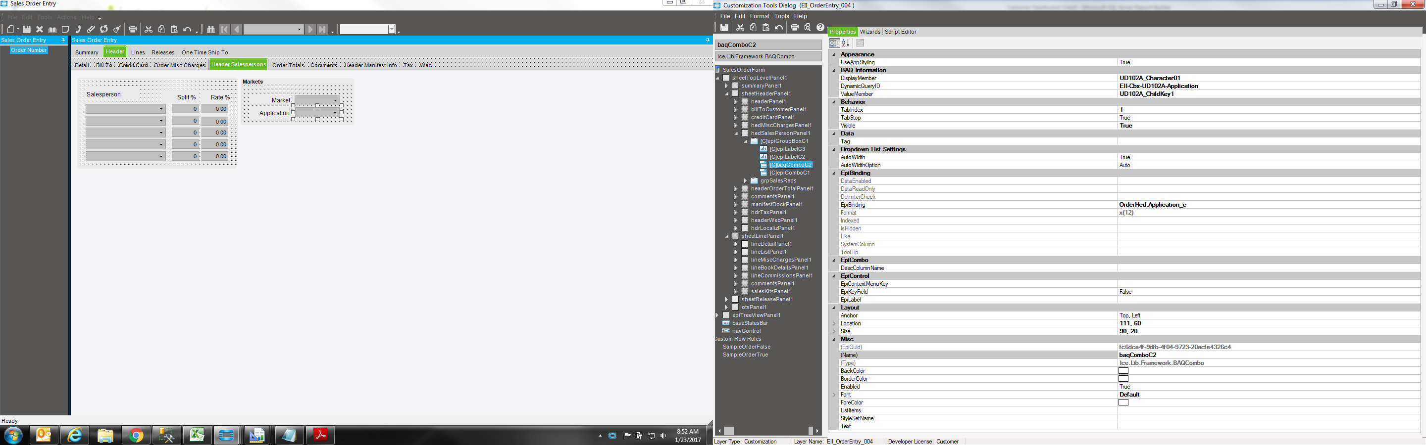

Show us a screenshot of your BAQ Combo box properties, that’s probably where the issue is.
The BAQ Combo box labeled application is the one with the problem

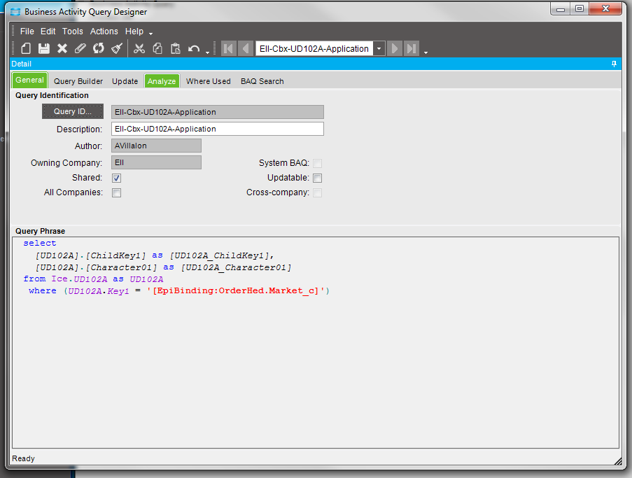

What is your BAQ querying? Can you share a screenshot of your BAQ?
You shouldn’t need ANY code for a BAQ Combo to work.
here is the pic of the BAQ
ha! you are using BAQ Markup… I wonder if that doesn’t work with UD fields… (not sure why it wouldn’t)… can you remove the BAQ Markup and see if that works ok (meaning the value always populates even if its not filtered)
let me try that give me a sec
i removed the markup and now it works
The question would be; how can i filtered and make the BAQ load?
You can add the filter in code… instead of in the BAQ Markup… on a BeforeDropDown Event
ok thanks Jose really appreciated
