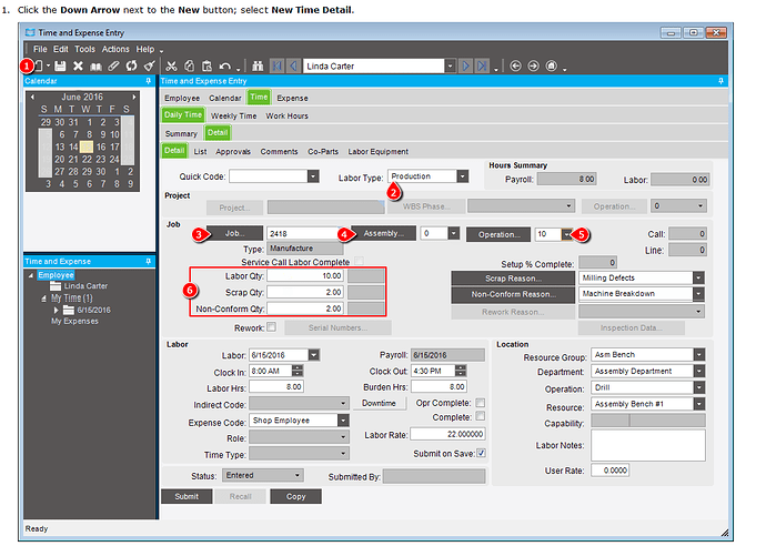

@Anders
Better way is use Time entry to report labour.
Production Management → Job Management → General Operations → Time and Expense Entry
Time Entry - Details
You use the Time > Daily Time > Detail > Detail sheet to define the job and operation the labor occurred. You can enter as many details as you need to account for the total labor time that displays on the Time > Daily Time > Summary > Detail sheet.
Note: If your company uses the MES interface, the application pulls the time details recorded through this interface during the selected day. You can then review each detail on this sheet, updating the time entry records as you need.
To enter a time detail:
