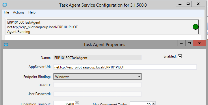

You mention reporting tasks so I immediate think of task agent and the reporting db. I assume something is misconfigured on one / both of those
Task agent points to my pilot server and its uniquely named App Server

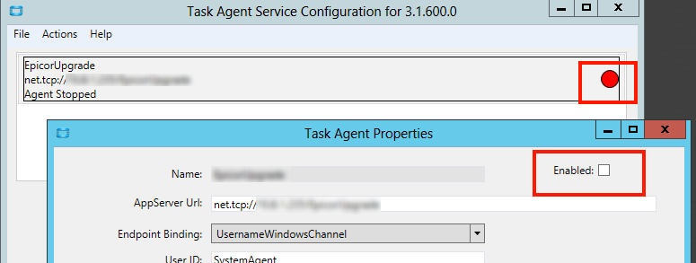

Preventing the problem:
Preventative actions would include disabling the specific task agents via the task agent service configuration / admin console as shown below (I don’t mean the service) prior to cloning the VM. It seems you need to have the service running in order to remove the agent which would register the task agent at its destination from its origin on the cloned VM.
