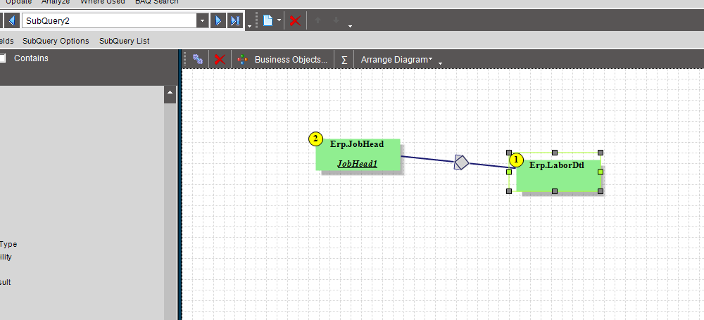

I’m trying to link this “ClockInDate” to the Top Level. The Top Level table is JobHead. All other subqueries are joined to JobHead by PartNum. Since the LaborDtl DOES NOT contain the PartNum field I have linked it to the JobAsmbl table joining the two using Company, JobNum and AssemblySeq fields.

Labor is clocked to Operations. Try joining Labordlt to JobOper Or JobOpDtl. you will also need to joining the job op table to job head.
So what you are saying is that Subquery should have the LaborDtl and JobOper/JobOpDtl tables but the JobOper Table would be the one “linked” to the JobHead Table in the Top Level - correct?
I’m still receiving zero records

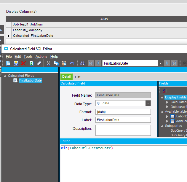

Do a sub query with JobHead and labordtl grouped by company and JobNum then do a calculated field that is the MIN(laborDtl.ClockInDate) to get first labor date.

to get the first time a job was started I used a subquery left joining back on job head to get all jobs. im doing this to compare an actual start (labor) to a planned start (jobhead)
The labor dtl has the job number already in it, so no real reason to bring in the job header table on that subquery. Just laborDtl table, with Company and Job grouped, and the calculated field that @Craig showed there. Although I would probably use the laborDtl.ClockinDate, but that’s probably splitting hairs.
no idea why i used createdate. i assume there was a reason, but no telling.

I have tried every which way i can think of to link the LaborDtl table to my upper level which is using JobHead. At this point they are linked with Company and Job grouped, and the calculated field that @Craig showed, I am still receiving zero records.

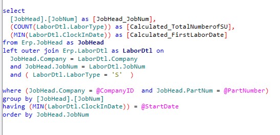

Judy,
I get results using the BAQ below. As a test what if you remove the having subquery criteria (having (MIN(LaborDtl.ClockInDate)) = @StartDate), do you get results then?
Epi_Example_1
