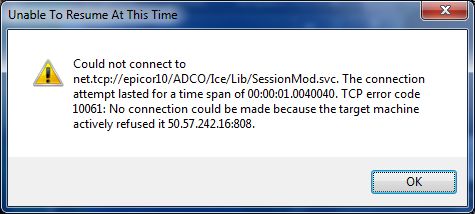

I am having one workstation experiencing random disconnects from the Epicor server
and a message box pops up sometimes… What is the IP address listed in the message box??
huh
it is IP address of the epicor10 machine. and :808 is a port number for tcp connection
but it isn’t the ip address of the epicor server - we use private ip addresses and that is a public address :confused:
Could your dns be flaky? Try hard coding the client to the server ip address as a test?
We have a logon script that flushes the DNS, but I entered the ip address of the epicor10 server in the client hosts file. I will keep an eye on this
