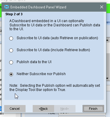

And I recall there being a setting for when to refresh (either Auto, or with a Retrieve button), when creating the child with the Wizard.
Edit
Correction … The choice is when adding a dashboard via the Sheet Wizard, not when linking the UD table as a child.

One of the options in the Sheet Wizard - > Add dashboard, is to include a retrieve button. You could do that on another form - as a test - to see what kind of code it creates, than manually reproduce that in your form. The wizards are notoriously “one direction”, as in they can add code to your customization, but aren’t very good at removing it, or altering it once it’s done. That’s why I suggested making a test form that you can later disacrd.
