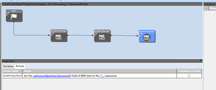

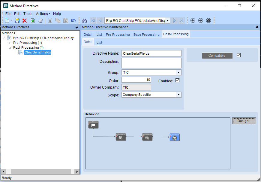

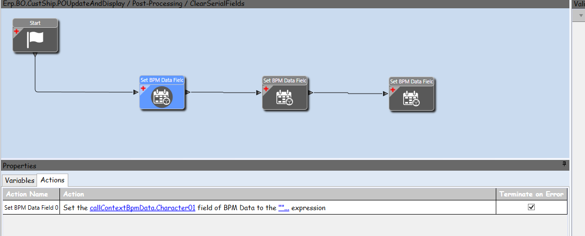

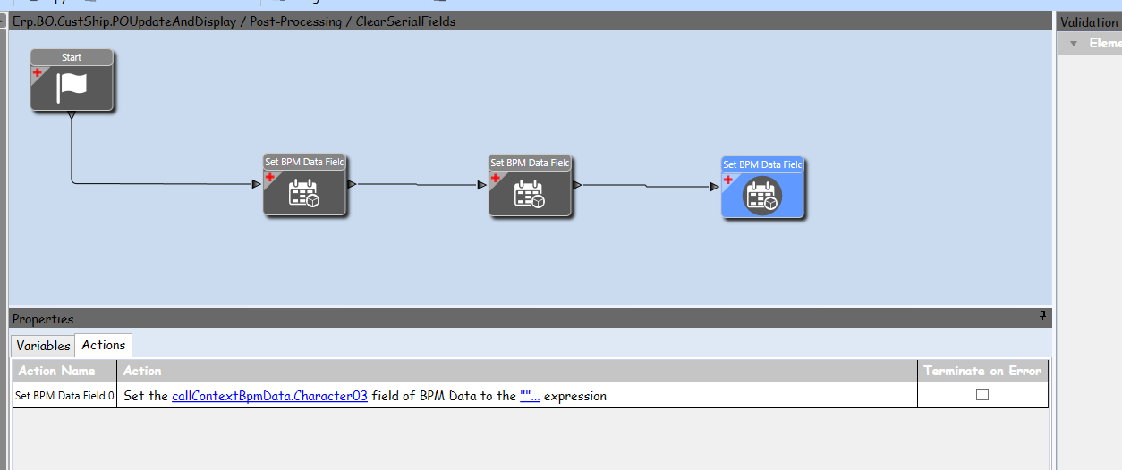

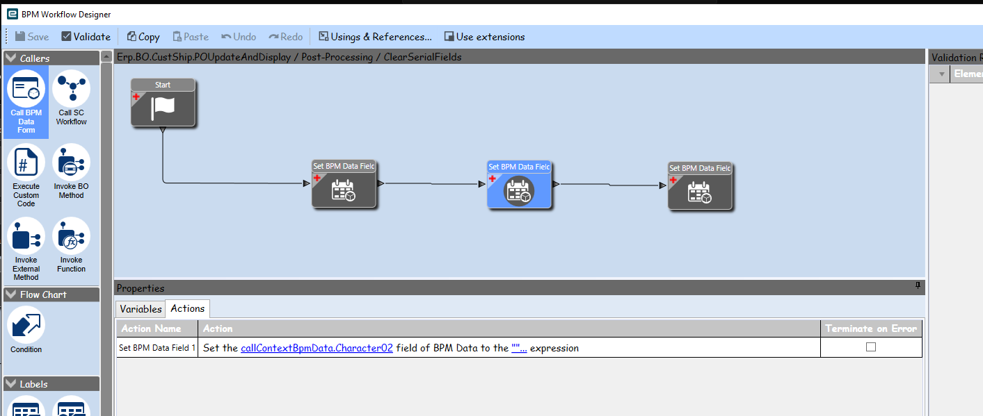

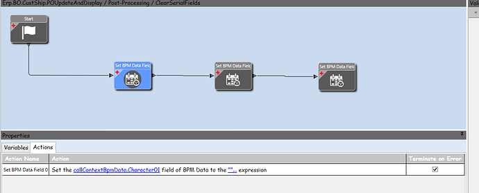

Although the solution is not clear it caused me to look further in which I found a BPM that updated the fields from the Call Context. I added some code to clear the call context fields after updating which resolved the issue.
I know it’s a long time, but by chance you’ll still remember how you solved it, I’m in the same dilemma.
We are on a different version now but here is the BPM. I can send you a solution file if you like. We were using the handheld screen to ship so that is why we are using the POUpdateAndDisplay. In this case the PO stands for Pack Out not Purchase Order.
That would be great.
