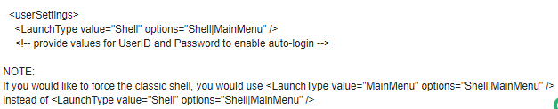

Their .sysconfig files can be changed.
or change the target line of their shortcuts:
You can update the client config
<LaunchType value="MainMenu" options="Shell|MainMenu" />
Thank you Nathan and Dan - That works perfectly.
