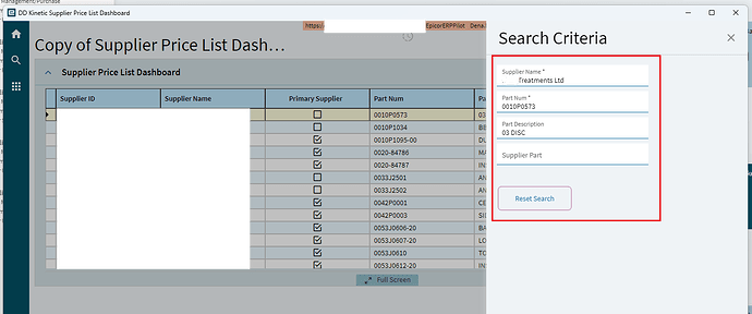

We have recently upgraded from 10.2.700.19 to 2024.1.4 and am attempting to uplift my first dashboard from Classic to Kinetic.
I copied a simple existing dashboard which has 1 grid and a tracker, deployed it as Kinetic, created new menu then launched to see how it looked.

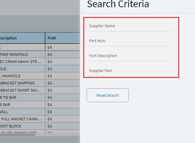

The Tracker (search criteria) automatically loads from the overflow menu, which loads all records (this is ok) but it also populates the search criteria fields with data from the first row in the grid.
I can’t seem to figure out how to get it to load the Tracker with the fields empty and even if I manually clear the fields and enter new values the “reset search” button or enter don’t seem to do anything. The list in the grid will not filter based on values entered into these fields.

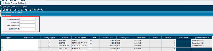

Classic Dashboard:

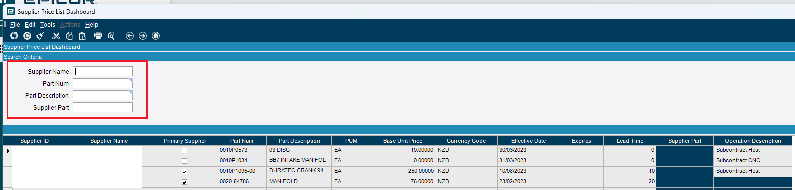

Kinetic Dashboard:

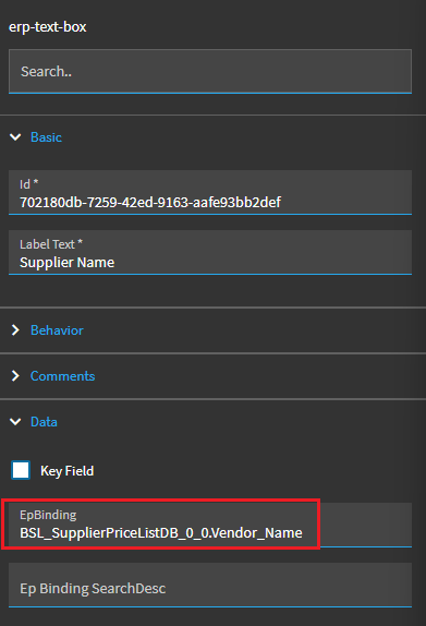

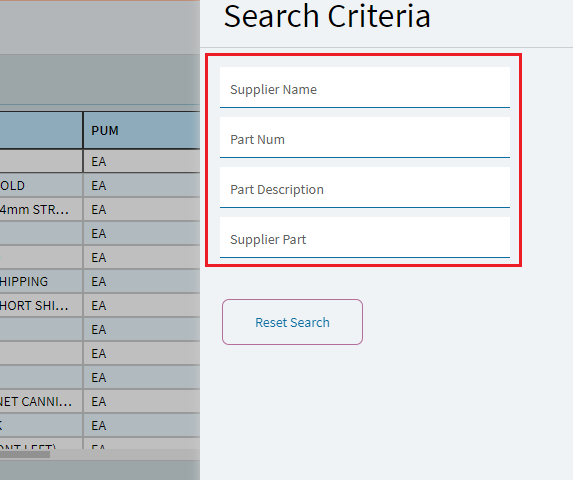

I have made some progress though - The Text Boxes which were automatically created when the Classic dashboard was deployed as Kinetic had the wrong Page name in the EpBinding field.

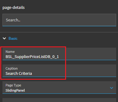

Search Criteria Page Name - ends in 0_1
EpBinding of Text Box Components - ends in 0_0
EpBinding of Text Box Components - corrected binding to match Page name
Search Criteria fields are now empty - rather than being populated by first row of grid. However, they are disabled when dashboard is first loaded
Once you click the Reset Search button they become editable

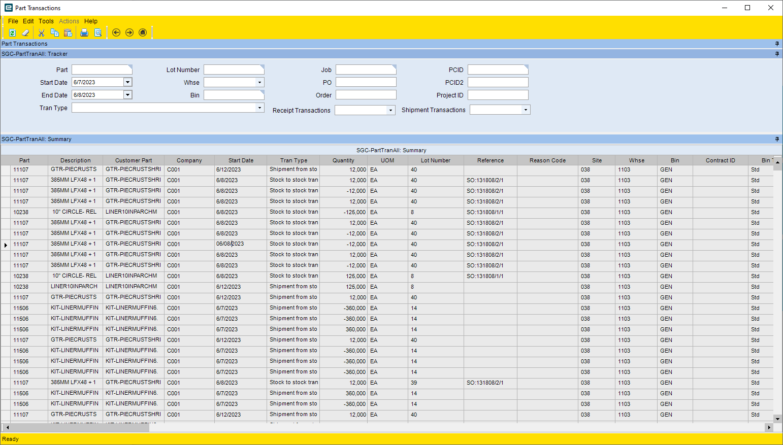

Saw this post today and wondered what it might mean for you:
You are not using TransView for your EpBinding … but you’re getting the same behavior as this other post. If you add a row-update widget to an event that fires after Form_OnLoad, and set your four bound values to nothing … maybe you’ll get editable textboxes from the start.
So I ended up figuring this out and we also had a training session with an Epicor consultant and I validated the steps were correct:
  1. Deploy simple classic dashboard as Kinetic (has 1 BAQ/Grid View and a non-customised tracker)
  2. Open in Application Studio and preview > Search Criteria fields are populated with results from first row and Reset Search button does not work. Search Criteria button to open Sliding Panel has been added to Panel Card overflow menu.
  3. Change Search Criteria Page type to “sliding Panel”
  4. Sliding Panel page is currently bound to same Dataview as Panel Card Grid. Create a new Dataview for Sliding Panel page which is linked to existing BAQ.
  5. Update the Sliding Panel Text Boxes EpBinding to point to new Dataview created > Search Criteria fields are no longer populated with selected row data
  6. Search Criteria fields are not initialised - you have to click Reset Search button in order for them to become editable. Fix the “Search Criteria” button on click Event > the Event Next Action needs to point to correct event (search_initialize_BSL_SupplierPriceListDB_0_0) as the event it references (search_initialize_BSL_SupplierPriceListDB_0_1) does not exist.
