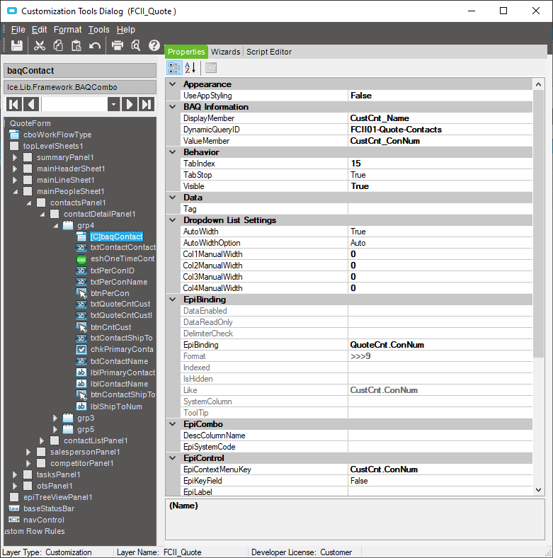

The classic BAQ Combo looks like this

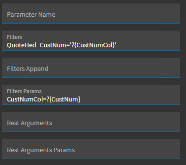

I believe I need to use the Filter and Filter Params fields. I’ve tried several different combinations, but I would think this would work.
Running this, I see a server side error of:
Query Id: FCII01-Quote-Contacts. Invalid column name EpiBinding:QuoteHed.CustNum

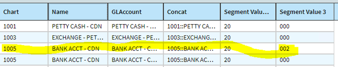

If you run BAQ: GLAccount-Chart_K it basically returns every active GL. If viewed from the Combo Box it shows duplicates of many Charts. If the filter/filter params were working as intended I should only see Charts that exist with the Division and Department codes that were selected in the ComboBoxes baqcGLDivision and baqcGLDepartment
In other words if you can GLAccount-Chart_K you may see the following results
But if the user selected 20 in baqcGLDivision and 000 in baqcGLDepartment then the 3rd results for GL 20-002-1005 should not be in the results

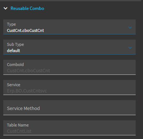

No, I couldn’t get it to work. I ended up moving away from the BAQ combo in favor of the built in Kinetic reusable combo type CustCnt.cboCustCnt. I then filtered on custnum.

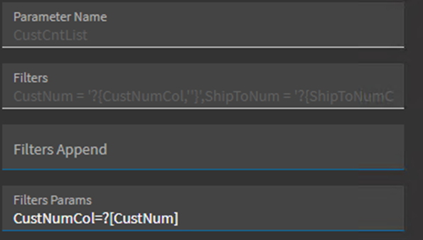

I can’t attest to all your bindings, but in your Filters, use curly brackets { } instead of straight [ ].
