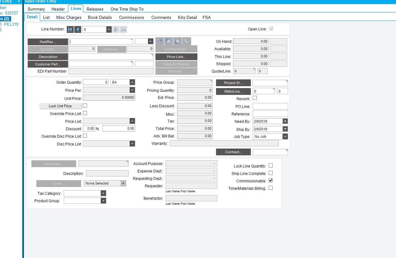

The expected correct behavior when the user types in the part:
When the search button is used INCORRECT behavior nothing happens:
Shouldn’t both be calling the same method? Does it have to do with the way I am capturing the part number initially?
