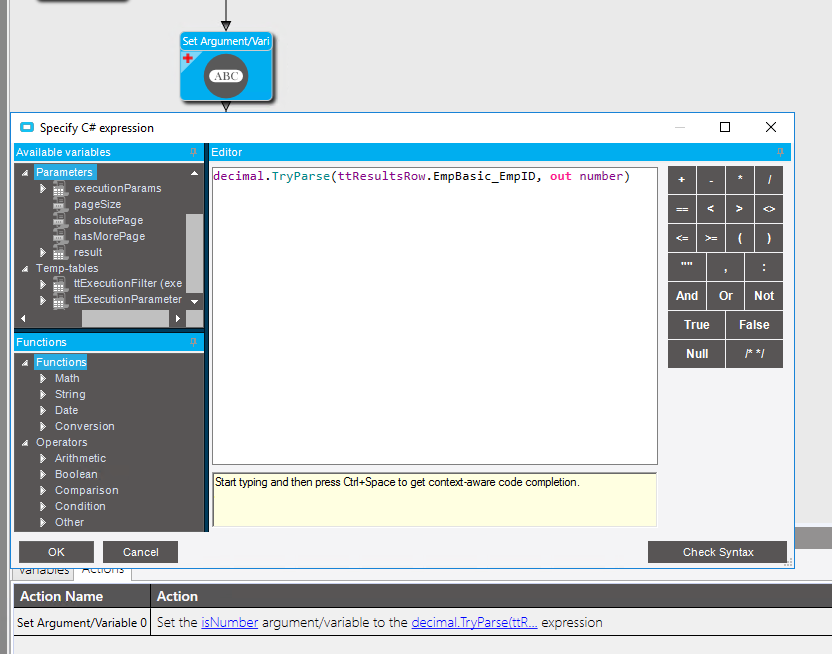

You could use decimal.TryParse(… , …) which returns a true/false AND the converted value (if it’s convertible).
Here’s a set arg/var widget that uses it. It sets a boolean variable (isNumber) and a decimal variable (number) to the parsed field (Employee ID field).
So are there 2 variables in there IsNumber (Booleen or Booleen? type) and number (Decimal or Decimal? Type
When I put the information in there with just the IsNumber variable the word number does not seem to be recognized.
Right, i created 2 variables isNumber (boolean) and number (decimal).
Okay. I got it to validate. I am now testing.

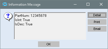

If you use int.TryParse(...) it will limit it to integers.
PN just int
PN with Decimal

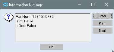

(note that IsInt is false)
Non Int or Dec

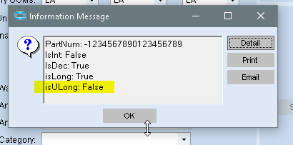

If you want to exclude negatives, replace any leading - with an X) before calling <type>.TryParse()
If you need numbers bigger than want an Int can hold, use Long
expression for IsULong:
 (long.TryParse(BpmFunc.Replace(dsPartRow.PartNum,"-","X"),out tmpLong)) ?  true  :  false
