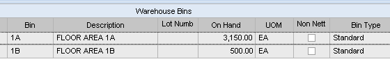

What I’m finding strange is that the grid normally shows the IUM for the UOM column.
I did a test where I have UOM Class COUNT with IUM’s of EA (which allows decimals), and EACH (which does not allow decimals). The default UOM for the class is EA
A part with the UOM Class COUNT and the IUM of EA, shows up as EA in all bins on the Qty Adj window.
that second row (in bin 1B) is what appears after doing a Qty Adj to 1B of +500 EACH (the UOM that doesn’t allow decimals). It still shows up as EA (and not EACH)
