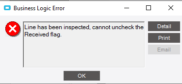

Right now our buyers are having an issue where they can’t modify the cost of a part received if that part is in inspection. We’re currently using DMRs to modify these parts which isn’t working ideally so I was wondering what others were doing when they come across these situations. Any feedback would be greatly appreciated!

Unfortunately, you can’t unreceive something if it’s in inspection.
