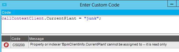

Well… thanks for the idea (and quick reply)… tried the simple line of code in C# to change the callContextClient.CurrentPlant value… it is read only:
